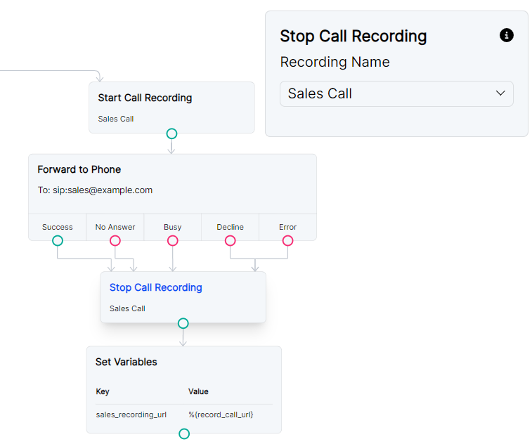

Example
You can pair this node with a Request node to send the recording URL to the webhook of your choice.
Please note that any later recordings in the Flow will overwrite the %{record_call_url} variable,
so the Request node should immediately follow this Stop Call Recording node or use
Set Variables to save this URL for a later request.
Record a call and save the URL to a variable.
