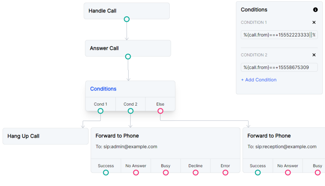

Use conditions to create a block list
In this example, we immediately hang up calls from specific numbers on our block list and forward call from a VIP directly to our administration number. All other calls will connect to the main reception number.
Block or pass through calls based on caller number.
