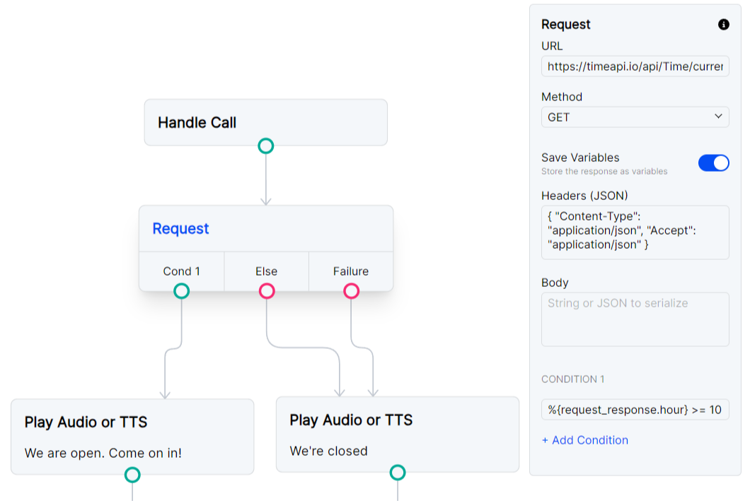

Route a call based on a request to check time
You may want your Flow to behave differently depending on the time of day. You can use timeapi.io to request the current time. This example uses an IANA timezone to look up the time and sets "Cond 1" to:
%{request_response.hour} >= 10 &&%{request_response.hour} < 20.
If the time is between 10am and 8pm, the success condition TTS will play. If a condition is not met, the call will be routed to the "Else" connector, which will play the TTS node. If the request fails, the call will be routed to the "Failure" connector, which will also play the TTS node.
Request node example with timeapi.io
