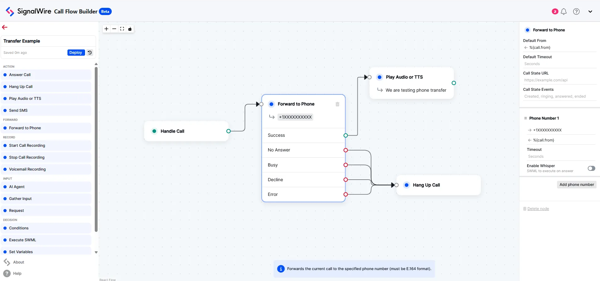

Preserve Original Caller ID When Forwarding
This example shows how to forward calls while preserving the original caller's phone number as the caller ID. This is useful when you want the person receiving the forwarded call to see who originally called, rather than your SignalWire number.
In this flow, the Handle Call node receives the incoming call and passes it to the Forward to Phone node,
which forwards the call to the destination number. The key configuration is setting the From field to %{call.from} - this variable contains the original caller's
phone number, ensuring that the person receiving the forwarded call will see the original caller's number on their caller ID rather than your SignalWire number.
If the forward is successful, the call connects directly. If the call fails for any reason (no answer, busy, declined, or error), the flow routes to Hang Up Call. This approach is particularly useful for business scenarios where you want to maintain transparency about who is calling.
Forward call while preserving original caller ID
