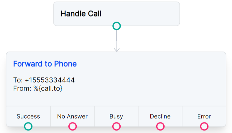

Variable Example​
Pass the caller phone number using a variable.

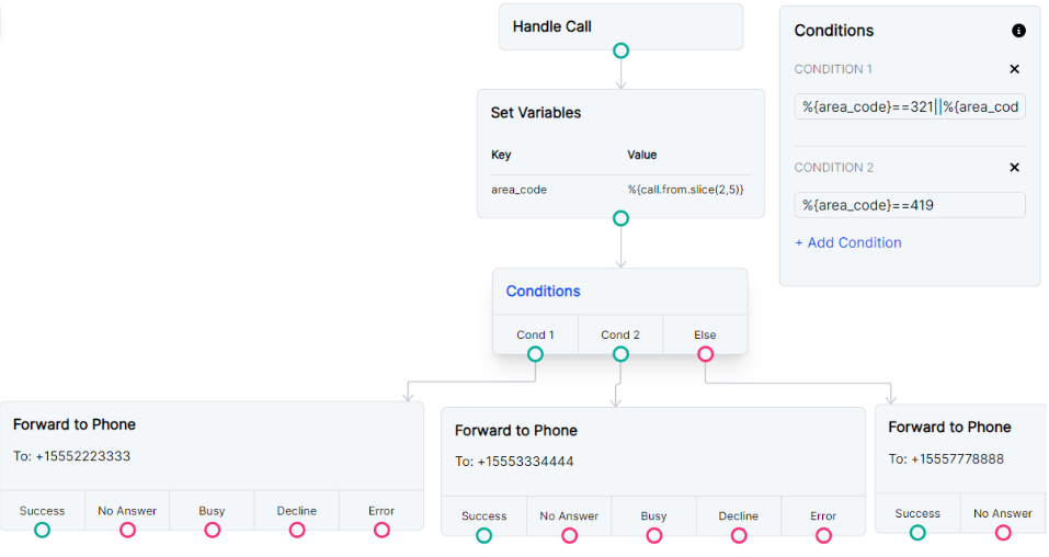

Within a Set Variables node, you can set the following:
Key: area_code
Value: %{call.from.slice(2,5)}
You can even combine this with a Conditions node as in the example below. Condition 1 uses the OR operator to check if the area code is 321 or 407.
If either of those is true, the call is forwarded to +15552223333. A second condition in the same node checks for a 419 area code and forwards the call to +15553334444.
Condition 1: %{area_code}==321||%{area_code}==407
Condition 2: %{area_code}==419
Use the `slice()` method to alter a variable.
