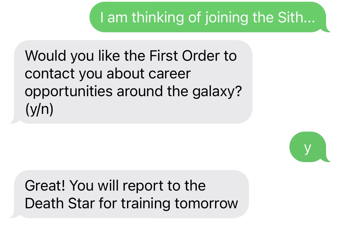

Now, it's time to test our application by texting into it!
A screenshot of a text conversation. The user texts 'I am thinking of joining the Sith...', to which the application responds, 'Would you like the First Order to contact you about career opportunities around the galaxy? (y/n)'. The user responds 'y', and the application answers, 'Great! You will report to the Death Star for training tomorrow.'
