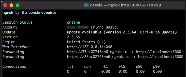

Once you have ngrok installed, you can run a command like ngrok http 5000
depending on the port that you want to use. Under the forwarding tab, you will see a ngrok URL that points to your localhost on the port you specified. You can use this URL to give SignalWire access to your web application as long as the ngrok window is running. However, keep an eye on the time as the free version will expire!

For the transcription status callback url, you would combine the route /message
with the ngrok url. The resulting webhook url would be something like https://33ec02748ba6.ngrok.io/message
