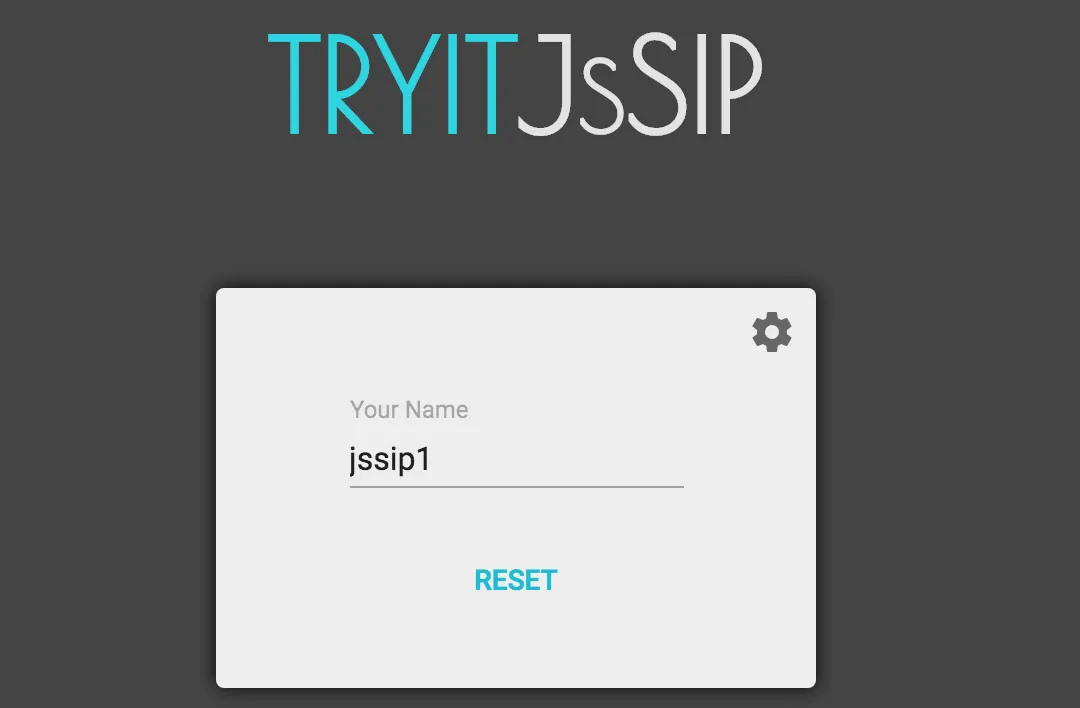

Now, you can test the newly created endpoint on a popular JS SIP (JSSIP) library:

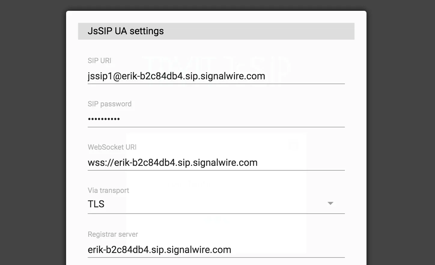

If you click the gear icon, you can configure the settings needed to connect to SignalWire. The SIP URI is your SignalWire SIP username and domain. The password set on your SIP endpoint can be used in the SIP password section to authenticate. The WebSocket URI is your domain with an appended wss://. To match the encryption on SignalWire, set the transport to TLS. The Registrar Server should be set to your domain.
Once you've saved the entered information, you will see the endpoint register and turn from yellow to green.
