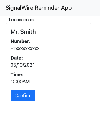

Our first route is the default, / , and it will store all of the reminders in the config.json file into a variable. Using the index.erb file in the GitHub repo, we will populate the data into a simple front-end display.
get '/' do
  @reminders = config['reminders']
  erb :index
end
/Call
When you click Confirm on the page above, the code in index.erb redirects to our next route, /call.
