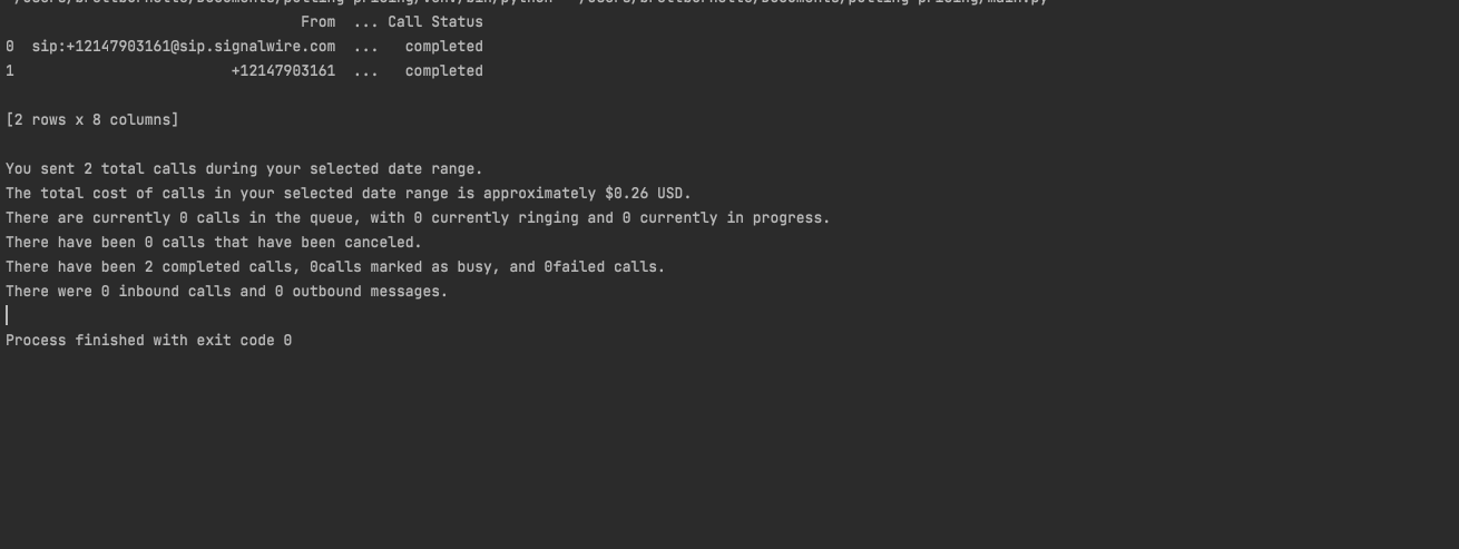

The final portion of this snippet prints a more holistic summary of what your Voice API usage has been based off the dates you've provided to the List Calls API, giving you insight of the total price of the calls, the total number of calls inbound and outbound, and how those calls performed.
print("You sent " + str(totalCalls) + " total calls during your selected date range.")
print("The total cost of calls in your selected date range is approximately " + formattedCost + " USD.")
print("There are currently " + str(total_queued) + " calls in the queue, with " + str(total_ringing) + " currently ringing and " + str(total_in_progress) + " currently in progress.")
print("There have been " + str(total_canceled) + " calls that have been canceled.")
print("There have been " + str(total_completed) + " completed calls, " + str(total_busy) + " calls marked as busy, and " + str(total_failed) + " failed calls.")
print("There were " + str(num_inbound_calls) + " inbound calls and " + str(num_outbound_calls) + " outbound calls.")
When all is said and done, your console will look like the image below, giving you that bird's eye view of your voice usage in that project. If you wish to see the itemized table that gives you full detail into every call, simply search for the CSV file on your computer that exported as a result of that script.
