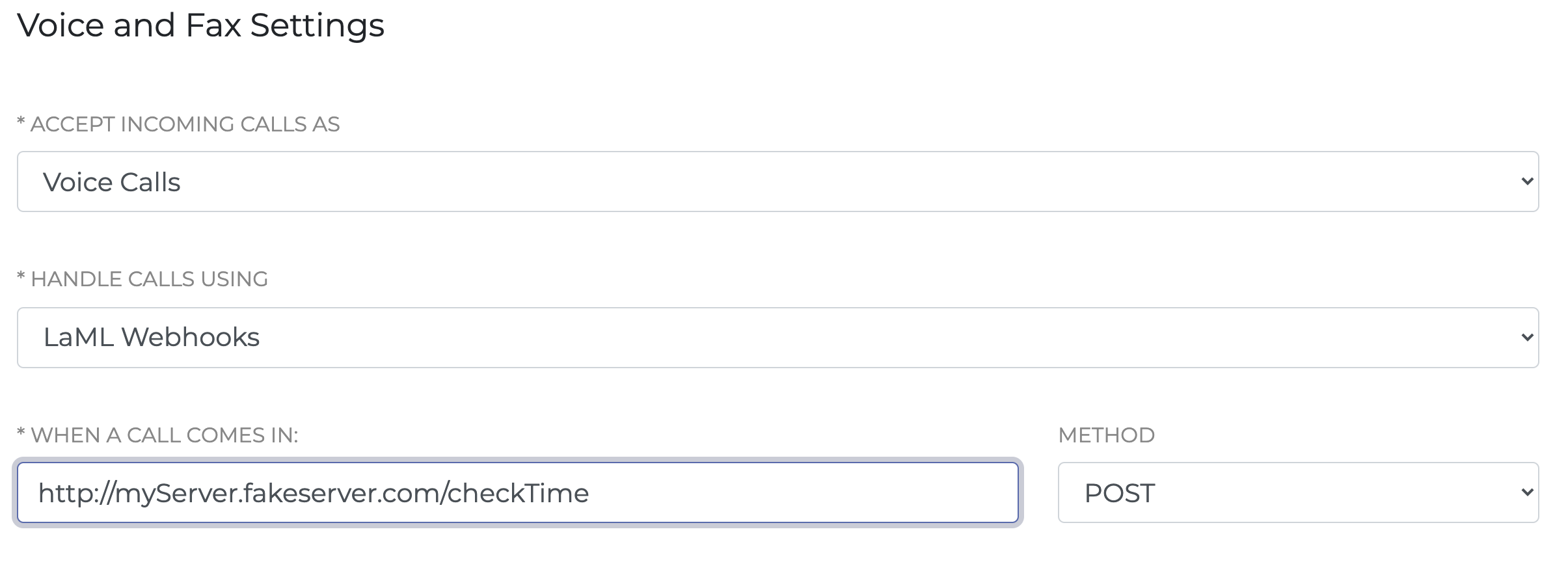

How to use the application
To use this script, you need to expose it to the web (through a server or SSH tunnel) and use it as a webhook for handling incoming calls under phone number settings. For this script, you would use the server url and the checkTime route, like this http://myServer.fakeserver.com/checkTime
