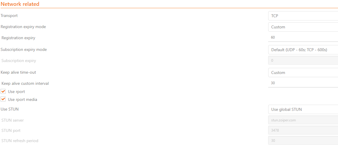

If you are having trouble getting your endpoint to authenticate, go to Advanced Settings and check to make sure your settings match the below photo!
