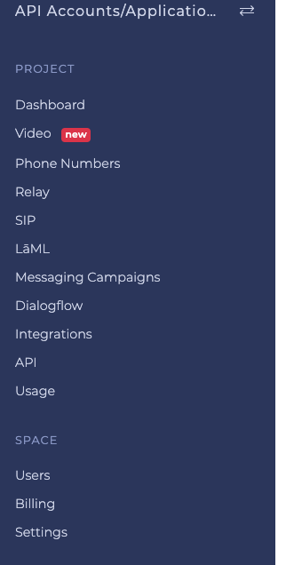

There are a number of different ways that you could trigger your outbound call, but below are two examples using Node.JS and cURL. You will need your SignalWire Project ID, auth token, and space URL. You can easily find all three values in a copyable format in your SignalWire Dashboard by clicking the API tab on the lefthand sidebar.
