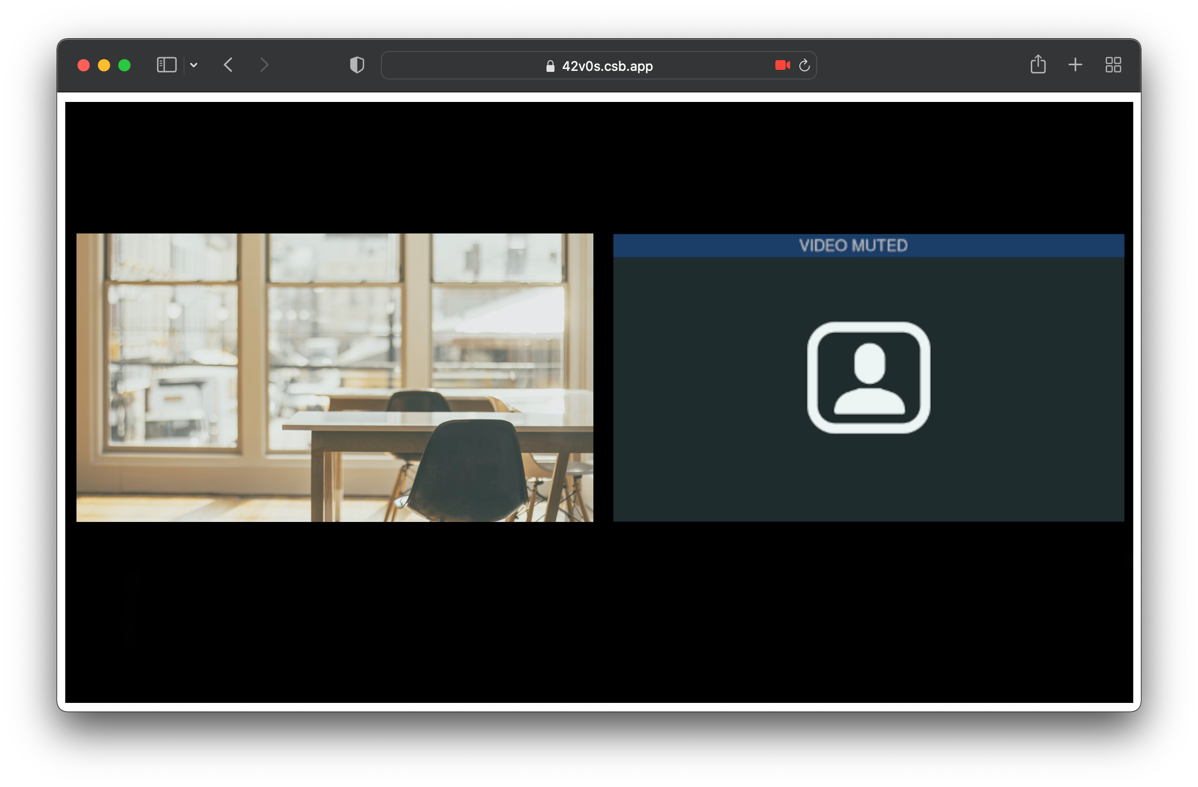

In the above file, we are using the JavaScript SDK to establish a video connection to a video room and to display its video stream into a div
To see it in action, you need to serve the HTML through a web server. You can upload it anywhere you like or, if you prefer, you can either:
- test it in our live demo: open the link and you'll be able to try it out right away. Or,
- test it locally. Here's how:
Step 1: Install Node.js
If you need to install Node.js see instructions on the official web page. Once installed, you can use the npx
terminal command that you will need in Step 2.
Step 2: Serve the HTML
Open a terminal and cd
into the directory where you saved your HTML file. Now run:
npx serve .
Your web page will be available in your browser at http://127.0.0.1:3000. Try opening it in multiple browser tabs at the same time!
