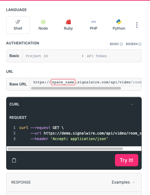

Check out our handy Try It feature in our docs by replacing the variables here with your own and running it in the browser. You can then easily copy the generated code in cURL or your favorite language!

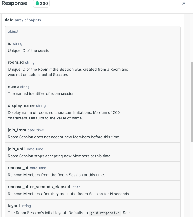

Next, we will loop through each room session object and store the data that we want to export in an array. In this example, we track session ID, room name, start_time, end_time, duration, and cost. However, you could access any of the objects returned in the data array of the API response. To see all of your options, go to the list room sessions endpoint and click the 200 OK under Response. This will populate a full list of all the returned data!
