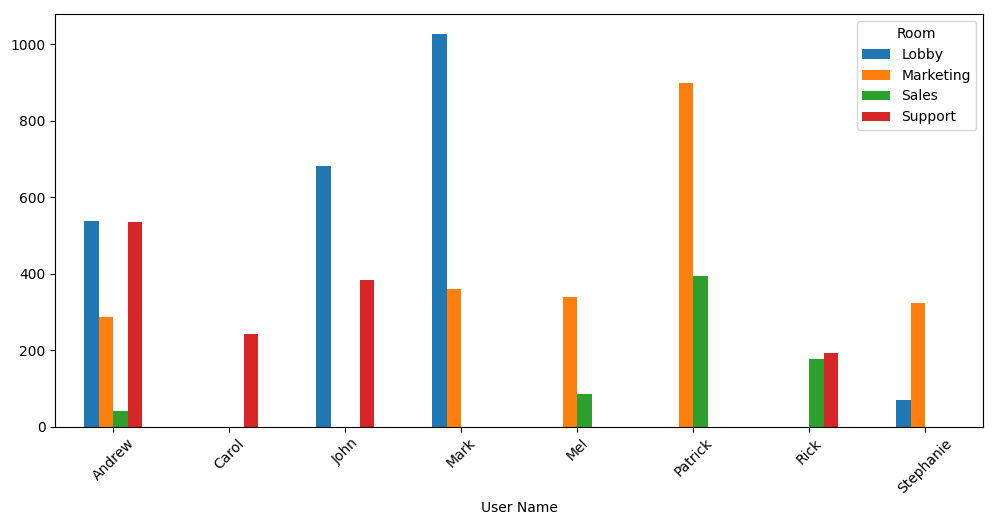

Here we create the membersDataFrame DataFrame, using the roomSessionMemberData list containing all of the data we need. We then print the data frame to the terminal, giving us the following output:
Lastly, we create a pivot table and create a graph from it, resulting in the following:

pd.pivot_table(
        membersDataFrame.reset_index(),
        index = 'User Name',
        columns = 'Room',
        values = 'Duration (sec)'
    ).plot(
        kind = 'bar',
        rot = 45)
plt.tight_layout()
plt.show()
