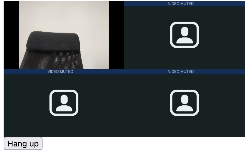

When the site is finished, it will look something like this:
Before we begin, try using the demo app. This is what we will build, step by step. Feel free to explore the codebase. You don't necessarily have to understand everything right now, but try tinkering with it. When you're ready, let's set up API access.

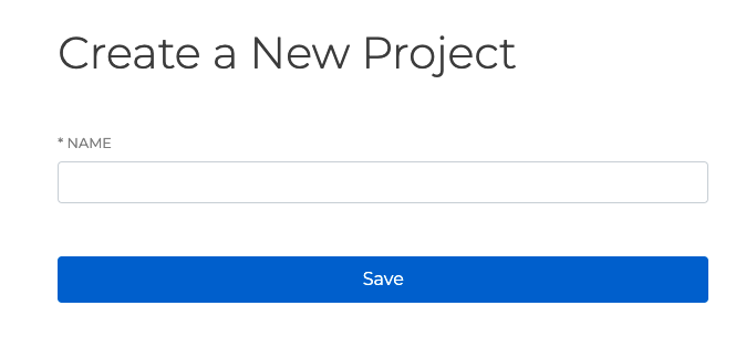

Once you've signed up and verified your email, create a new project. Chose any name you like. For this example, we will use "hello world".

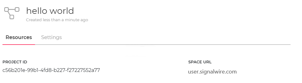

After the project has been created, you'll be taken to that project's page.
Two important pieces of information about our project are displayed there:
Space URL: You'll use this URL to access SignalWire APIs
Project ID: You'll use this UUID to specify your project to the API

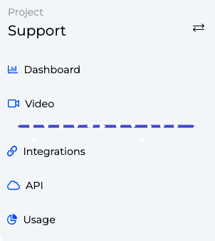

We can do that by navigating to the "API" page from the sidebar. Once you have navigated to the API page, click on "Create Token". Give it an easily idenitifable name, and make sure that the "Video" scope is enabled. Then hit "Save".
After the token is created, you will see it listed in the table.

Here is the final result of our development with a preview of some added features:
The most noteworthy thing about SignalWire Video technology is that it only streams a single video stream no matter how many participants there are. The video is composited on powerful SignalWire servers by stitching all of the individual video streams together. So you can invite as many people as you like to your virtual video party. Your app will run without a hitch.
