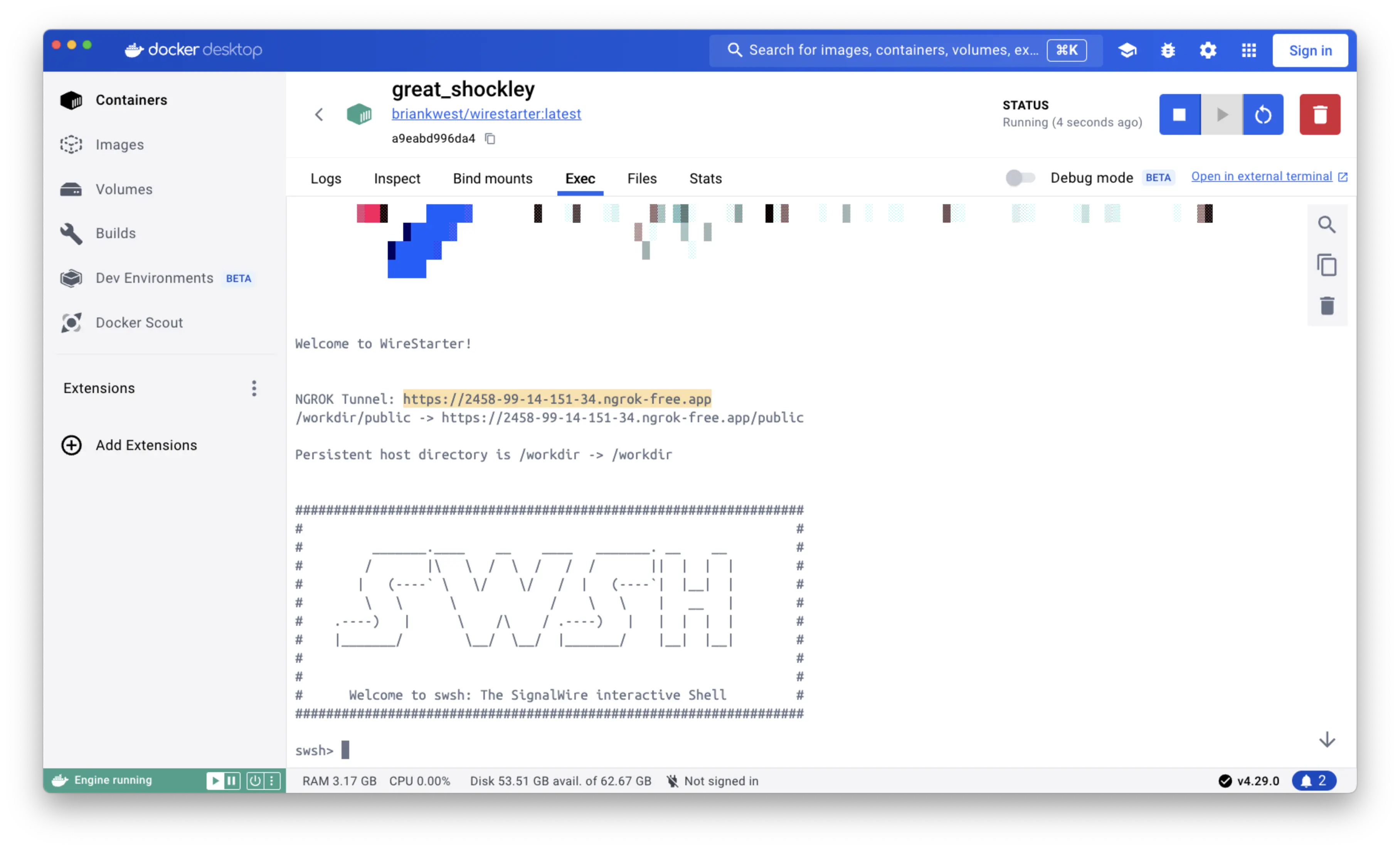

  1. Start and Configure SWSH
Now that WireStarter is installed and running, we will start SWSH (the SignalWire Interactive Shell) in the Container.
SWSH will ask for your SignalWire Space ID, SignalWire Project ID, SignalWire Project Token, ngrok Token, and ngrok Args (most users should leave ngrok Args blank). Make sure you have that information handy by opening the SignalWire 'tokens' page and the ngrok 'Your Authtoken' page.

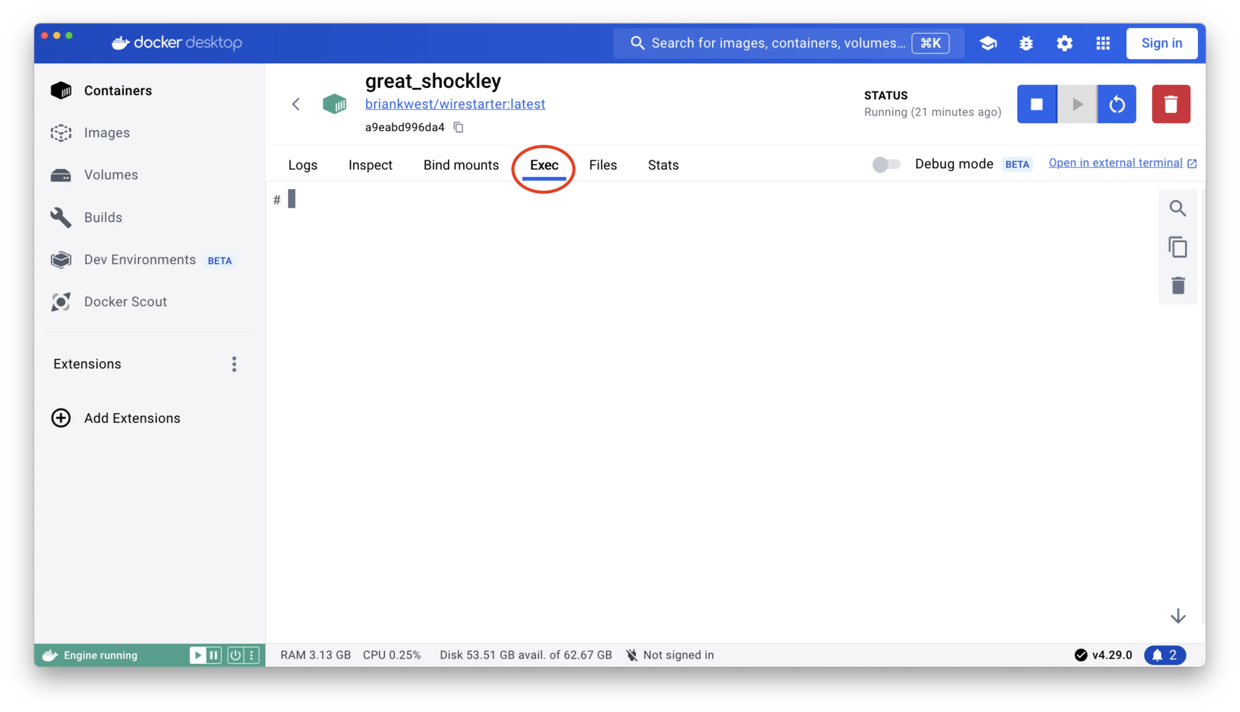

Switch over to Docker Desktop, and open the running WireStarter container. Click on the Exec tab to open the integrated terminal.
The Exec tab in the WireStarter Docker container.
In that tab, run the following command to start SWSH:
exec bash
After you enter your authentication information, SWSH will automatically open an NGROK Tunnel and display the NGROK Tunnel URL in the integrated terminal output. Save this URL - we'll need it in the next step!
SWSH running in the integrated terminal of the WireStarter Docker container, with the NGROK Tunnel URL shown highlighted.

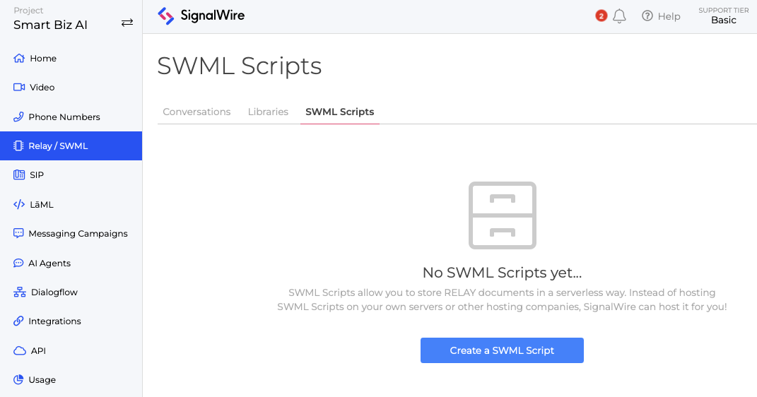

To create a SWML Script, navigate to the Relay / SWML page of your SignalWire Dashboard.
On that page, select the SWML Scripts tab as shown in the below screenshot.
Click Create a SWML Script. Name the Script "vicky", and copy and paste the following SWML into the text box labeled SWML.

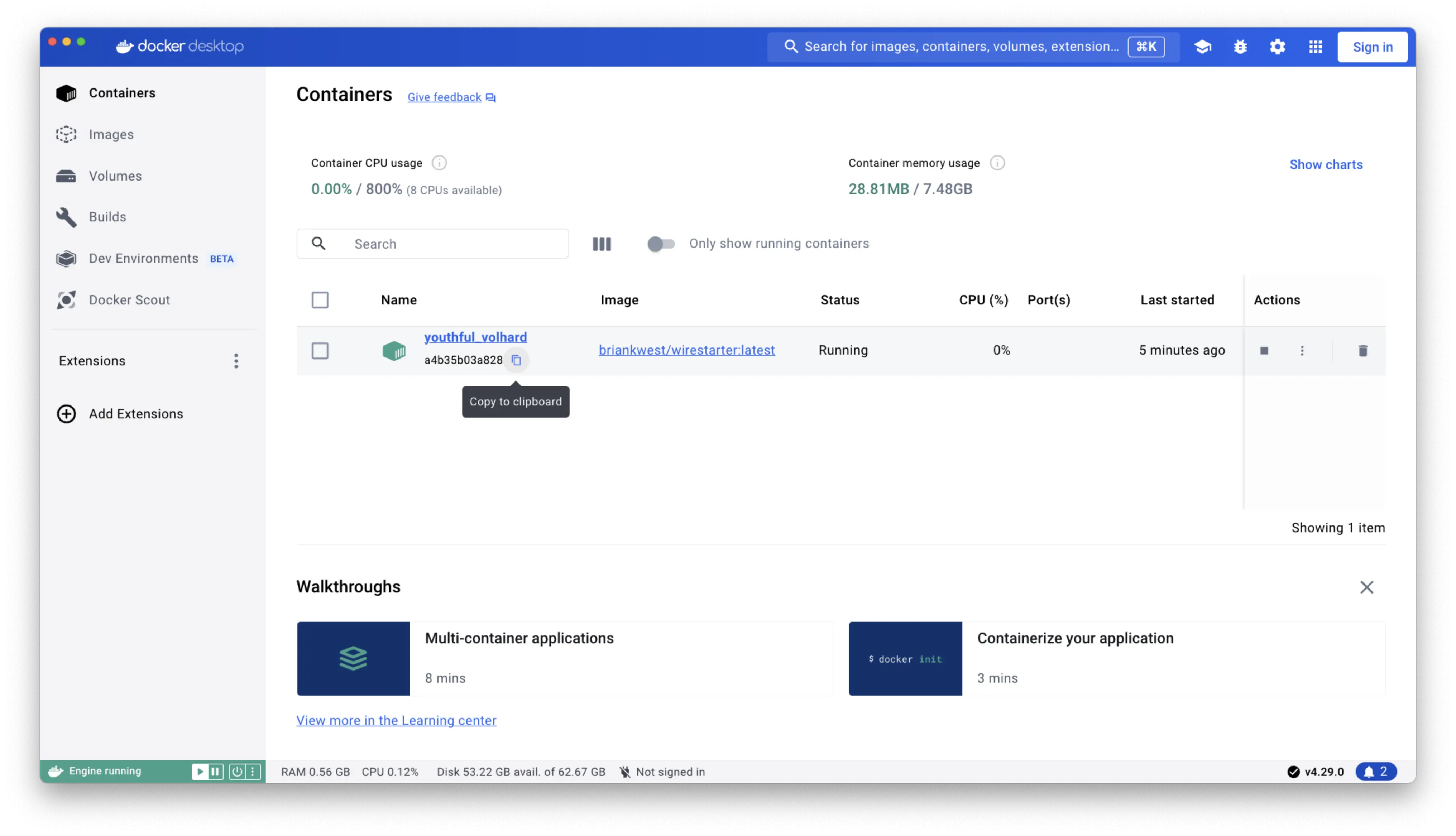

Copy the container ID from the Containers view in Docker Desktop.
Container ID in Docker Desktop.
Finally, run the following command in your system terminal to copy app.py into /workdir/livewire/ within the WireStarter container. Replace [container-id] with the WireStarter container ID from Docker Desktop.
docker cp app.py [container-id]:/workdir/livewire/
Copying app.py into /workdir/livewire/ in the WireStarter container using the Docker CLI.

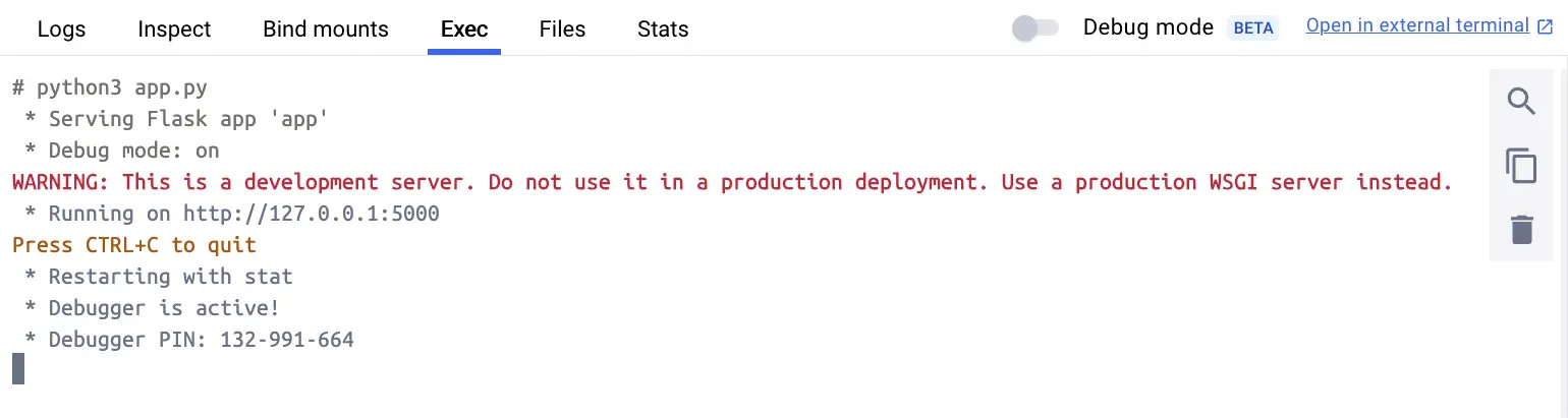

4. πŸš€ Run and test the application​
  1. Run app.py
Return to the Docker integrated terminal. From the root of the container filesystem, run the Python application using the below command:
python3 /workdir/livewire/app.py
Alternatively, you can navigate to /workdir/livewire/ and run python3 app.py.
app.py running inside the WireStarter container. Flask has started and is running on a local address.
