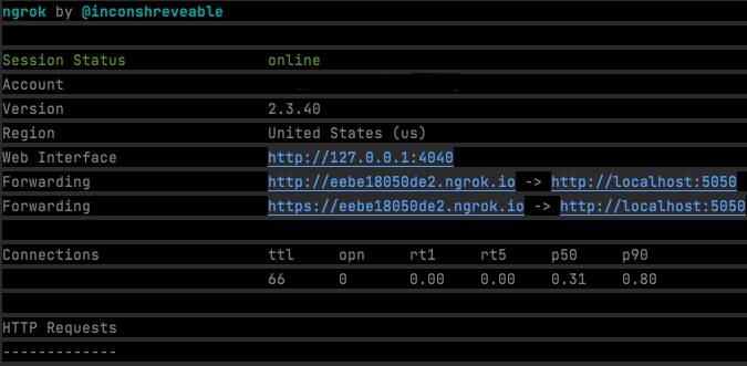

Now that our application is running, we can see it live on http://localhost:5050 so we must tunnel it using ngrok to be exposed to the internet. Once you have ngrok installed, you can run the following command in your terminal.
ngrok http 5050
Your terminal will then transform into an ngrok web interface for our application. From the screenshot below, we can see that our two webhooks for this example will have the domain https://eebe18050de2.ngrok.io and then can be differentiated by appending /slack or /signalwire, as seen in the app.py file.
With the ngrok standard account your forwarded domain will be an arbitrary scramble of alphanumeric characters which change every time you run ngrok so be sure to keep your tunnels running, or update your webhooks as needed.

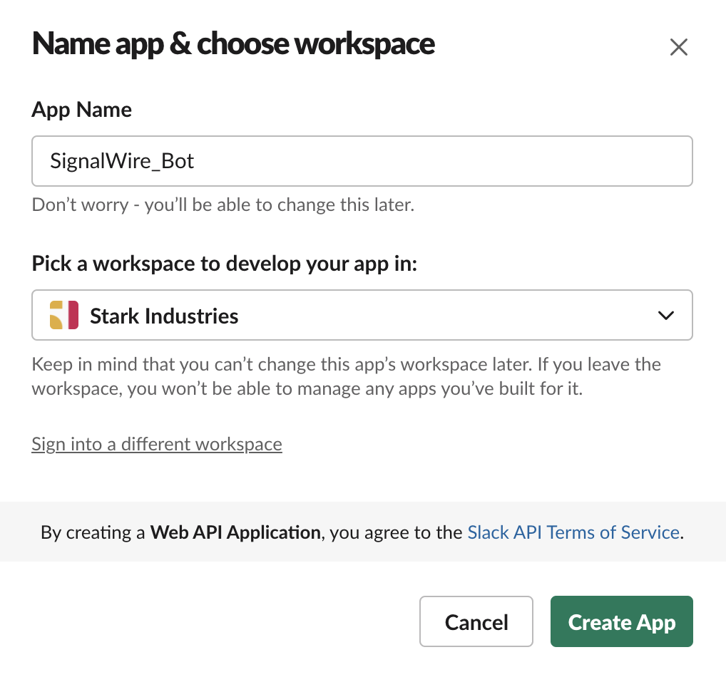

Set Up Slack Bot
Now that we have our slack webhook, we are ready for all of the steps to create our slackbot. After you have created your account, navigate to your Slack apps dashboard and select Create New App then From Scratch . Continue on with naming your bot and assign it to the appropriate workspace.

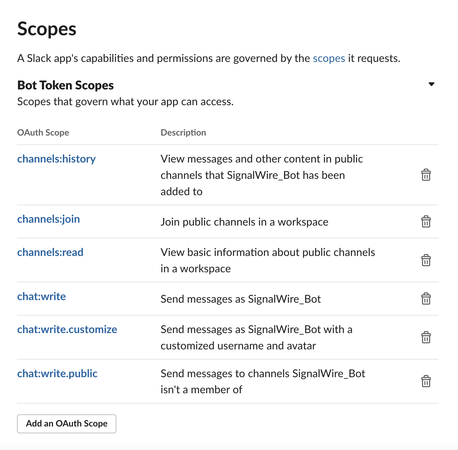

We must then set up the appropriate Scopes, which is the slack equivalent of allowing specific permissions. To do this, click on Permissions and then scroll down to Bot Token Scopes . Enter the following OAuth Scopes:
  • channels:history
  • channels:join
  • channels:read
  • chat:write
  • chat:write.customize
  • chat:write.public
Now that we have given our slackbot permission to do just about whatever it wants in slack, it is time to revisit the webhook we created previously through ngrok. We can connect this slackbot to our application by navigating to Event Subscriptions on the left menu and enable event subscriptions. This is the slack equivalent to a status callback within SignalWire.

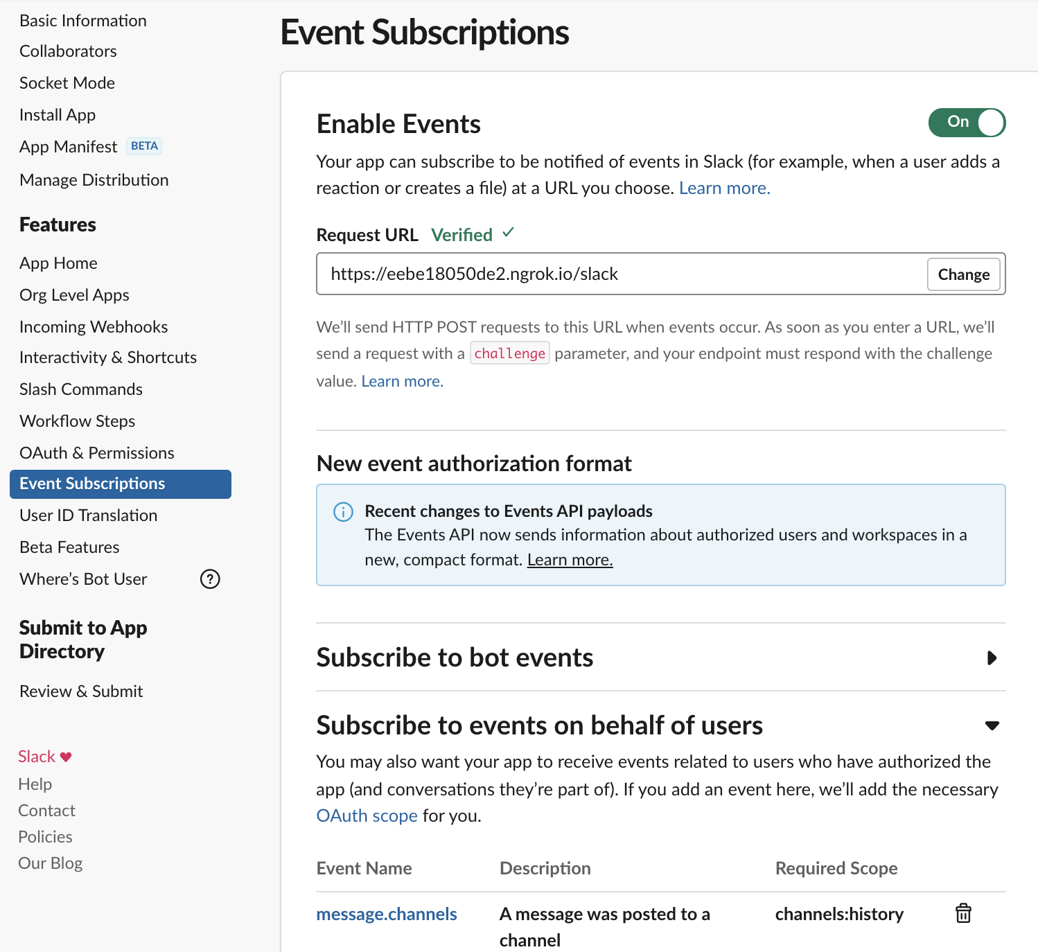

From the configuring webhooks section, we noted that our slack webhook would be https://eebe18050de2.ngrok.io/slack for this example. Your Request URL will look similar but your own ngrok domain will need to be used.
As noted in the above screenshot, you will need to scroll to Subscribe to events on behalf of users and subscribe to:
  • message.channels
Lastly, click Save Changes and it is time to go live with our bot.

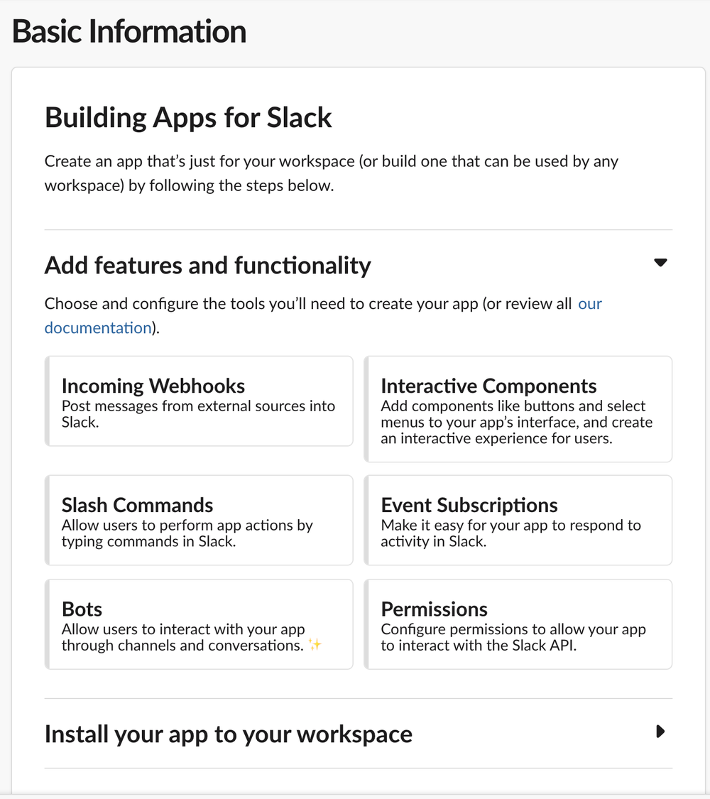

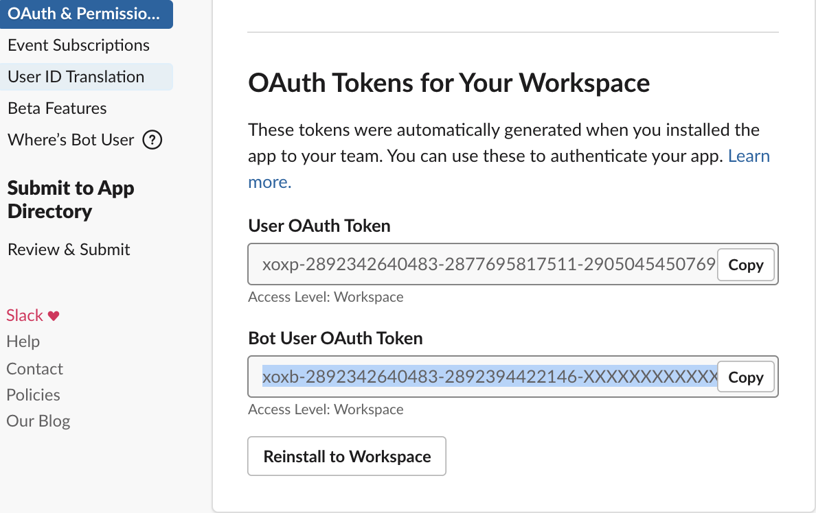

Navigate back to Basic Information and click on Install Your App to generate your Slack API Credentials, specifically the Bot User OAuth Token.
Take a note of the Bot User OAuth Token because this will later be entered into our .env file.

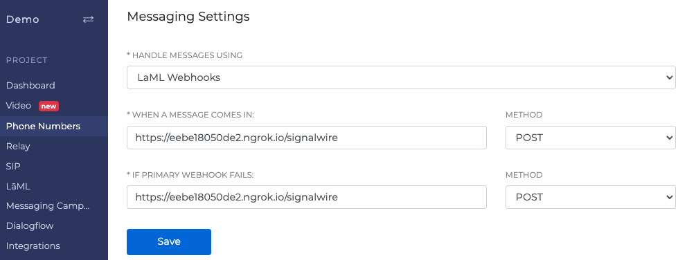

Within your SignalWire dashboard, we can associate this webhook to our phone number by navigating to Phone Numbers and then Edit Settings .
We will only be dealing with messaging so by scrolling down to Messaging Settings we can handle incoming messages using LaML Webhooks and then entering our ngrok domain with the /signalwire appended. And make sure to Save !

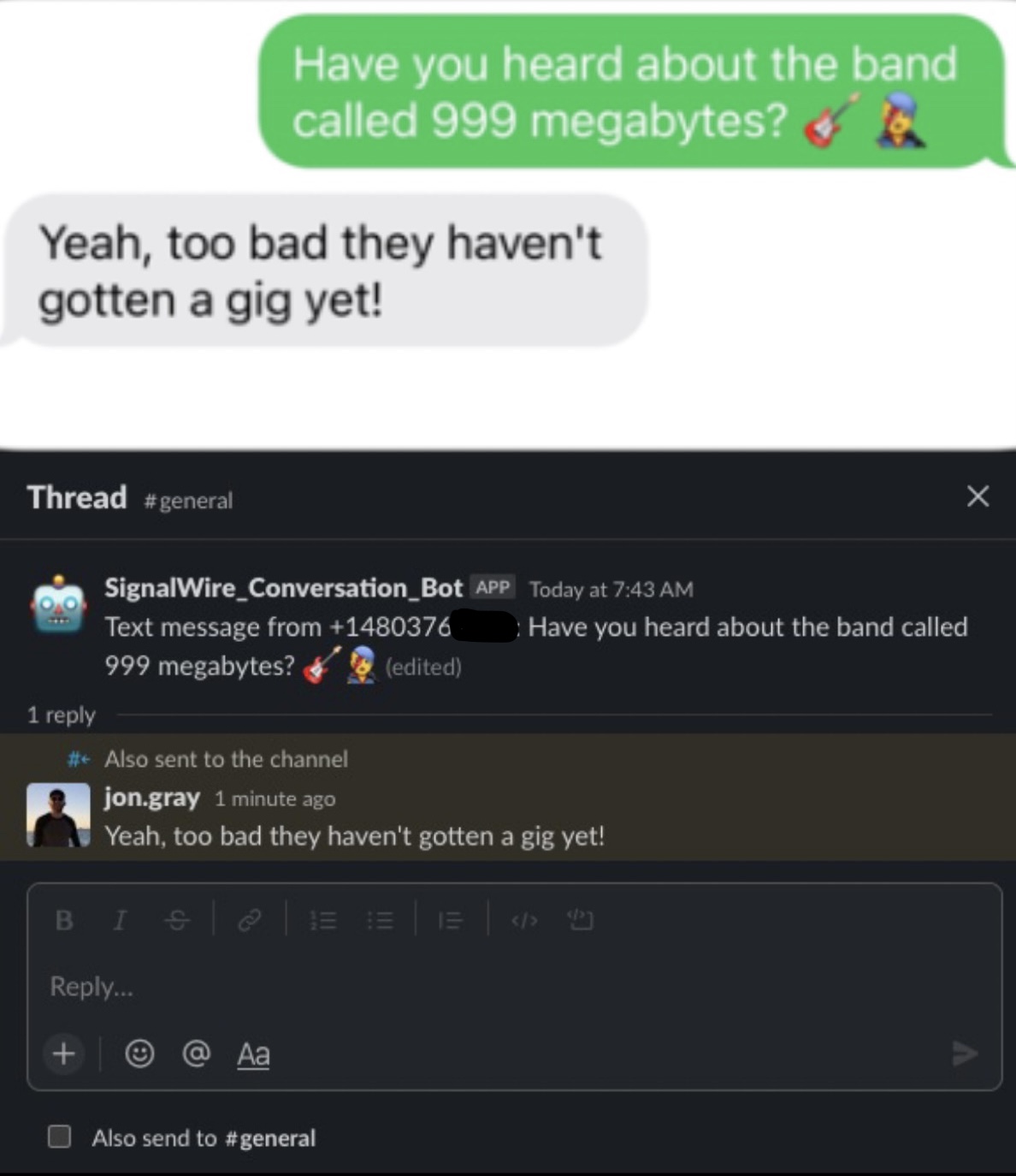

You can now test this application out by messaging your SignalWire number from your own device and look out for messages in the #general channel. You must reply in a thread to the incoming message to initiate a conversation

Next, we define the /signalWire route to our application. This is the route that is taken when a message is sent to your SignalWire number, and is then needed to be posted to slack.
This flow begins by reading the From and Body of a message, which was sent to our application via JSON file from SignalWire. These values are then stored and are used to post the message to slack from the Slack SDK. The explicit API call to send a chat message is seen on line 6 with slack_message = slack_client.chat_postMessage().
@app.route('/signalwire', methods=['POST'])
def signalwire_to_slack_flow():
    from_number = request.form['From']
    sms_message = request.form['Body']
    message = f"Text message from {from_number}: {sms_message}"
        channel='#general', text=message, icon_emoji=':robot_face:')
    response = MessagingResponse()
    return Response(response.to_xml(), mimetype="text/html"), 200
