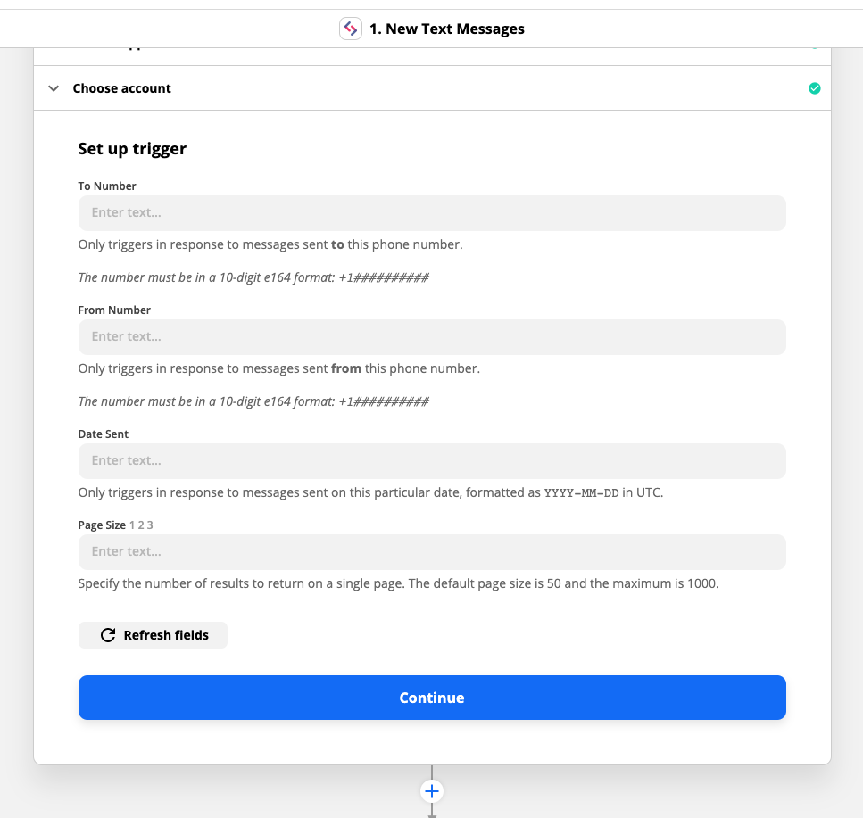

For the trigger, select SignalWire and choose whether you would like this process to begin with an incoming call or text. For this example, we'll be using the "New Text Messages" option. You'll then be prompted to Sign in to SignalWire. This is where you will use the API credentials we had discussed earlier. After logging in to SignalWire, you can then fill out the parameters in which the action is triggered. For this example, we'll just use the "To Number" parameter.
Notice
The "To Number" parameter in this scenario must refer to a phone number you own within your SignalWire Space and be written in E.164 format. For example, +12345678910.
