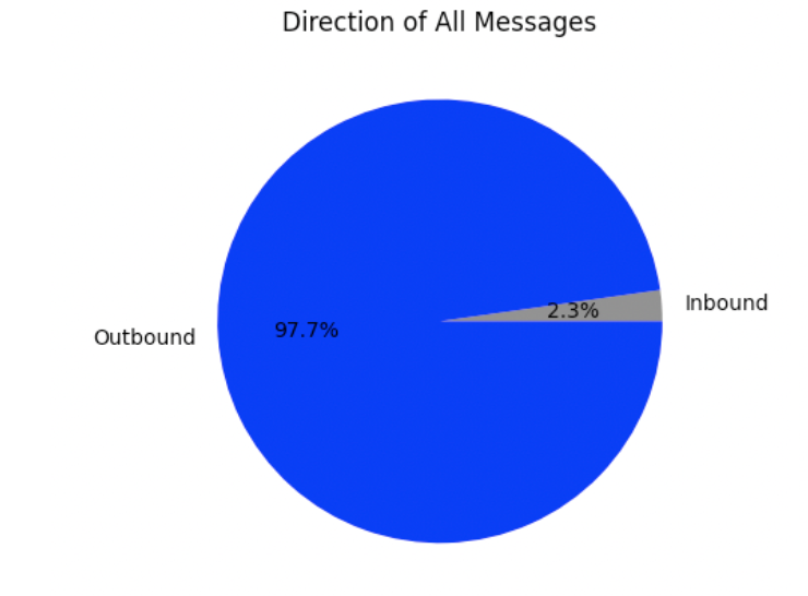

#Inbound vs Outbound Messages Pie Chart
inbound_outbound = [num_inbound_messages , num_outbound_messages]
my_colors = [ 'blue', 'grey']
vs_label = ['Inbound', 'Outbound']
plt.pie( inbound_outbound, colors= my_colors , autopct='%1.1f%%', labels= vs_label)
plt.title('Direction of All Messages')
plt.show()
plt.close()

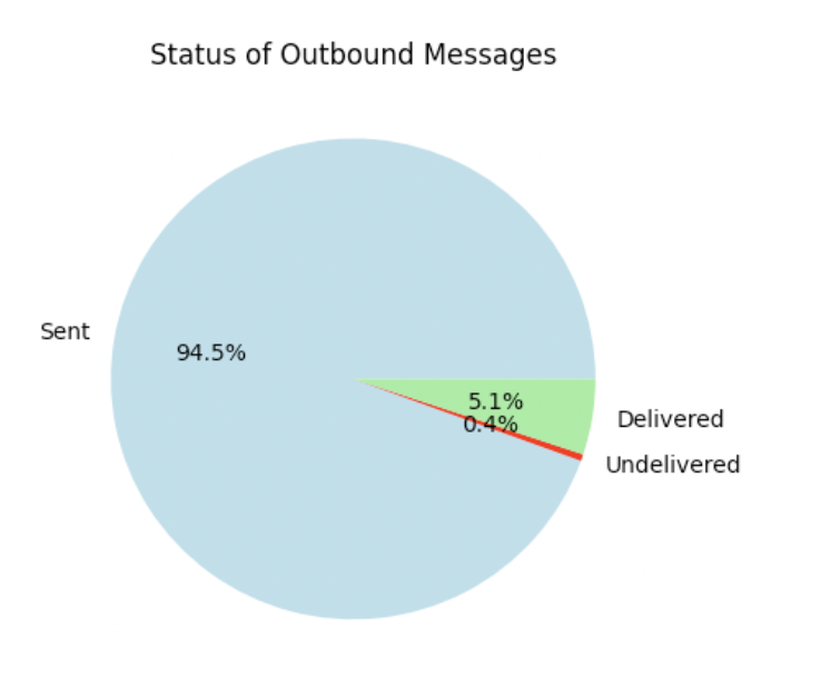

## Status of Outbound Messages Pie Chart
outbound_pie_int = [total_sent,total_undelivered,total_delivered]
outbound_pie_label= ['Sent', 'Undelivered', 'Delivered']
my_colors2 = ['lightblue','Red','lightgreen']
plt.pie(outbound_pie_int, labels=outbound_pie_label,autopct='%1.1f%%', colors=my_colors2)
plt.title('Status of Outbound Messages')
plt.show()
plt.close()

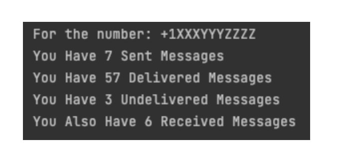

print("For the number:" + str(x))
print("You Have " + str(num_sent) + " Sent Messages")
print("You Have " + str(num_delivered) + " Delivered Messages")
print("You Have " + str(num_undelivered) + " Undelivered Messages")
print("You Also Have " + str(num_received) + " Inbound"+"\n")

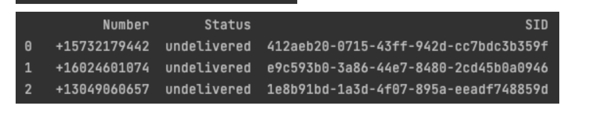

df=pd.DataFrame(un_m, columns=('Number', 'Status', 'SID'))
print(df)
Sample Outputs
