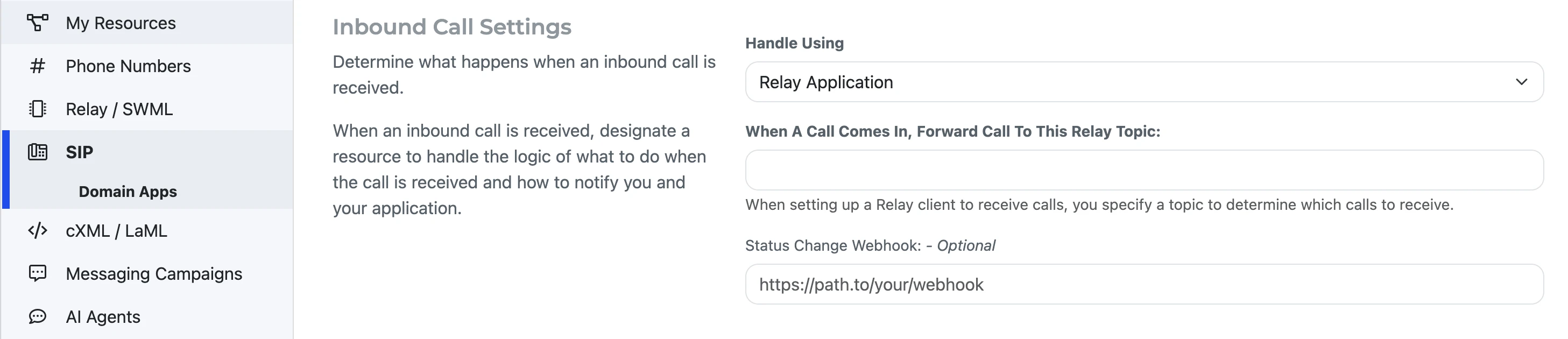

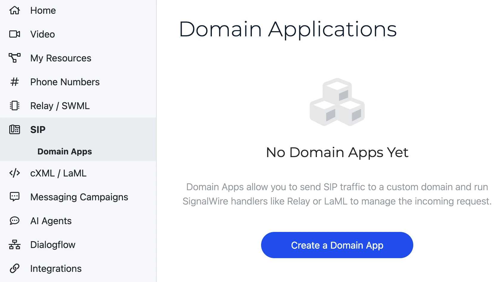

A Domain Application is a SignalWire feature that allows you to send SIP traffic to a custom domain and run specified logic. To define that logic, you can set up a handler in the SIP Space of your SignalWire Dashboard.
The Domain App page in the SignalWire Dashboard.
Relay Application​
If you are handling incoming SIP traffic with a Relay Application, you are defining your logic in a separate Relay application on your own server. Relay applications run different logic based on the context attached to incoming calls, so you will need to choose a context to label your incoming SIP traffic. The following example shows a Relay client listening for the "office" context then runs the logic inside the event listener callback.

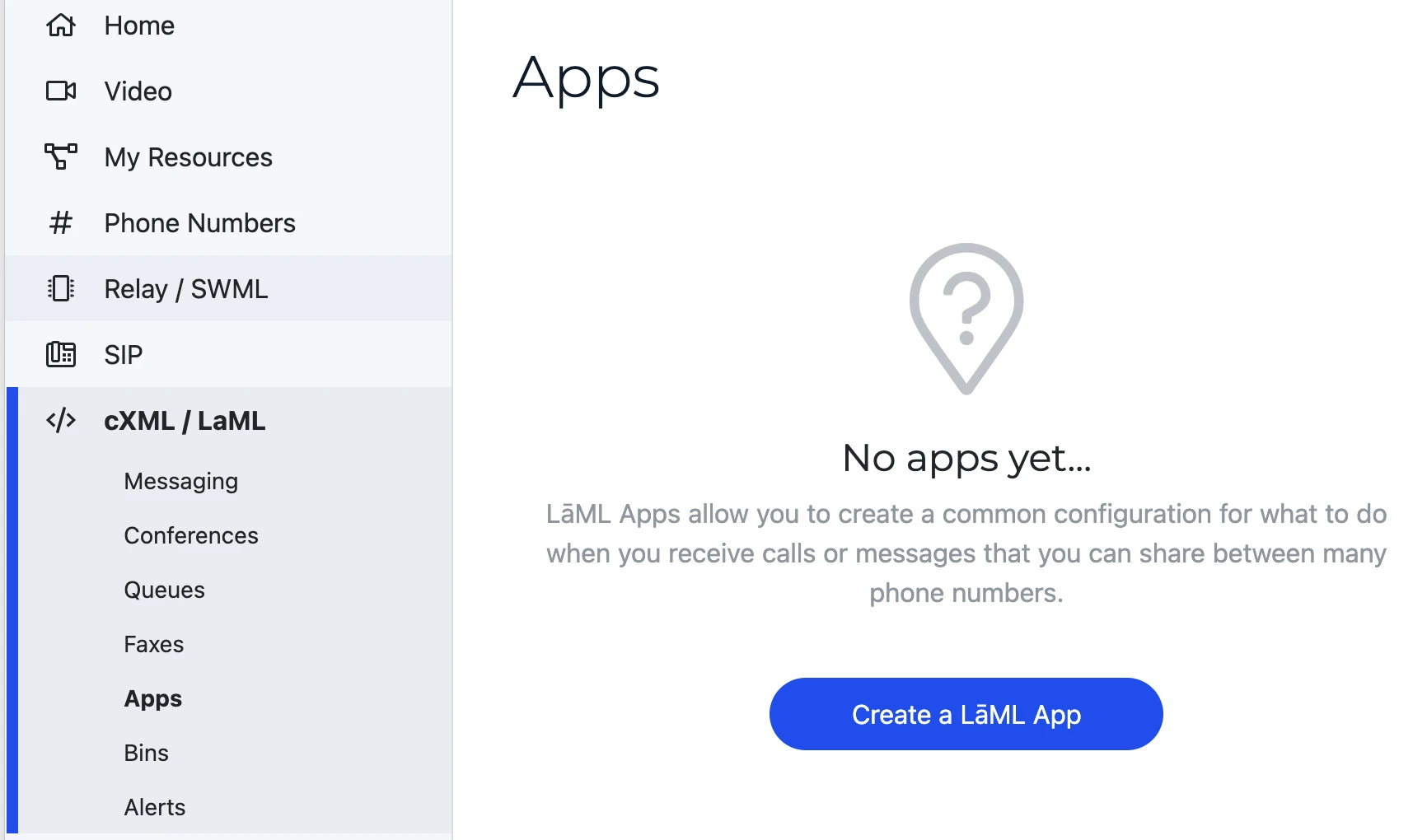

cXML Application​
A cXML Application handler will run logic the same way cXML Webhooks do, but they simplify the assignment of resources to cXML scripts. For example, you may have ten Domain Applications you would like to direct toward the same LaML Bin. If at some point you need to redirect the applications to a different LaML Bin, you would need to edit the settings of each Domain Application. However, if your ten Domain Applications were handled by a LaML application, you would just need to change one setting of the LaML application.
cXML Applications are created and managed in the resources Space of your Dashboard. After you create the LaML application, use the cXML application name to refer to it in the Domain Application settings.
