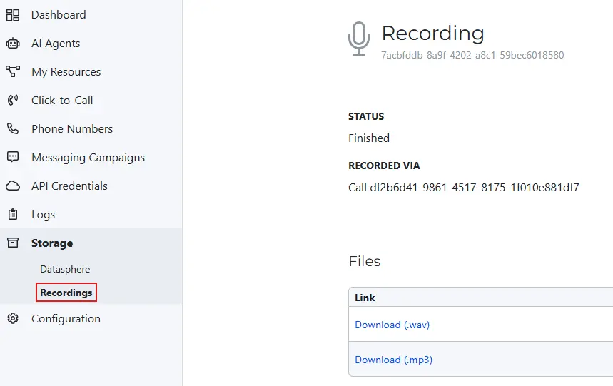

We used the <Record>
verb to start the recording, which will then be available from your SignalWire Space in the "Storage" section, within "Recordings".
