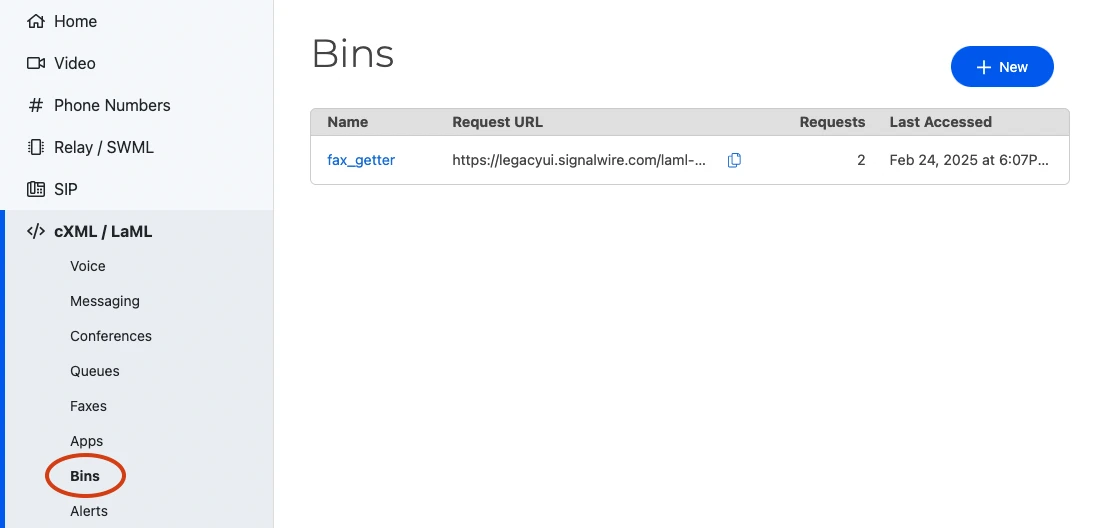

If you're still on Legacy UI, refer to Making and Receiving Phone Calls for detailed instructions.
