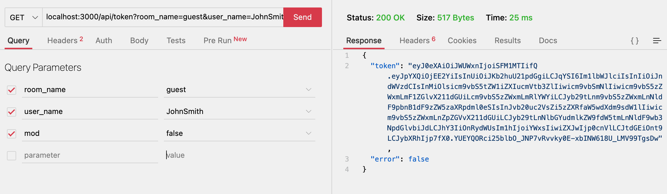

Testing the `/api/token` endpoint with Thunder Client
This simple backend will suffice to be able to conduct video conferences. But we will have one more endpoint to add here to support room previews.

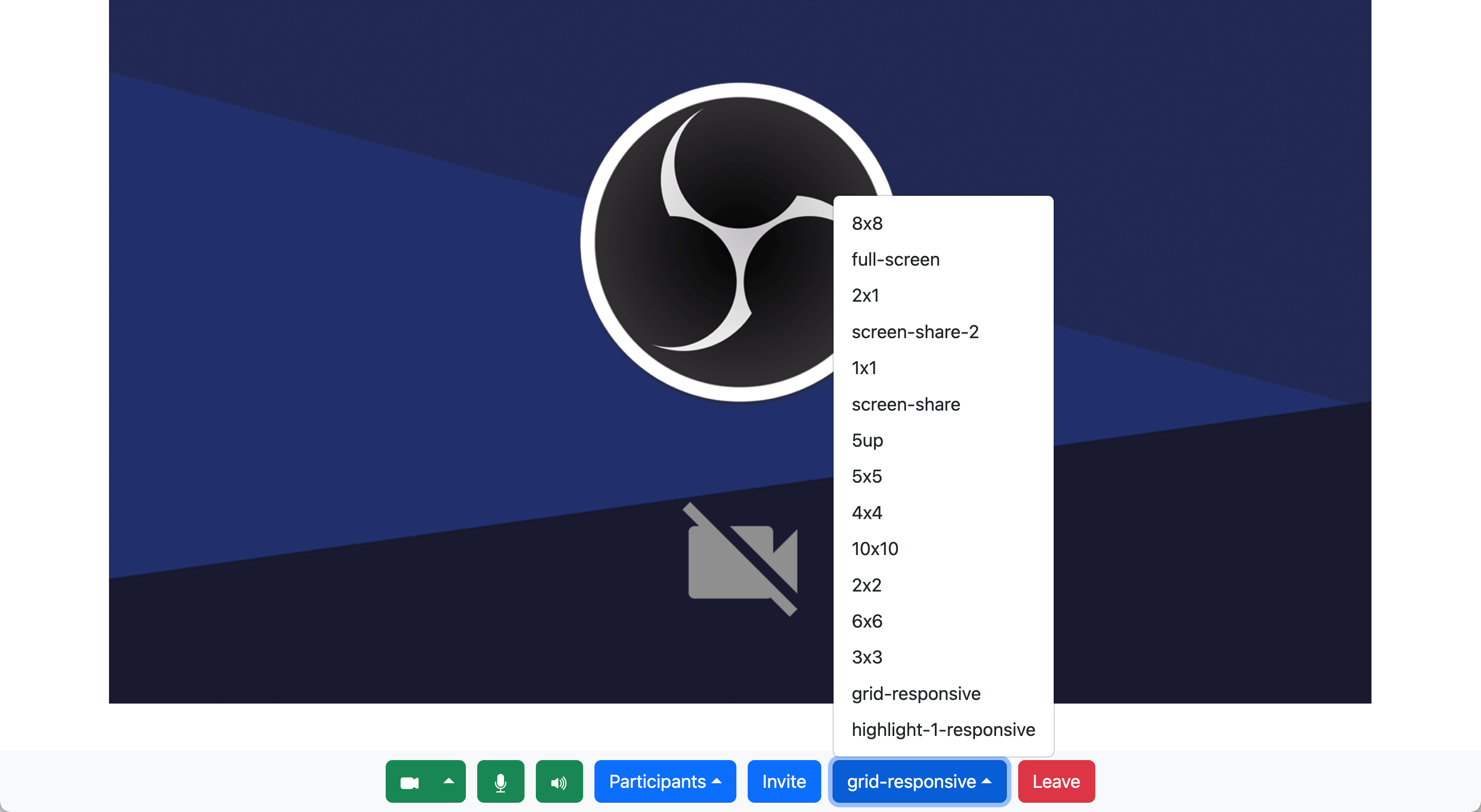

With the tokens received and the video feed showing, all that's left is for us to show controls.
The way we have chosen to go here is to have a separate <Toolbar/>
component which takes a
RoomSession object
and renders controls for the room. The RoomSession object is emitted by the onRoomReady
event from the
<Video />
component. For simplicity, each control is written as it's own component (
<Participants/>
<LayoutSelector/>
<Controls/>
We will go over each of these components briefly as we discuss the code.

The
<LayoutSelector/>
takeslayoutControls
fromuseLayouts
hook, which has a list of all allowed layouts, a way to change layouts and the layout currently being used. It renders a selector for layouts.
A video conference with all controls

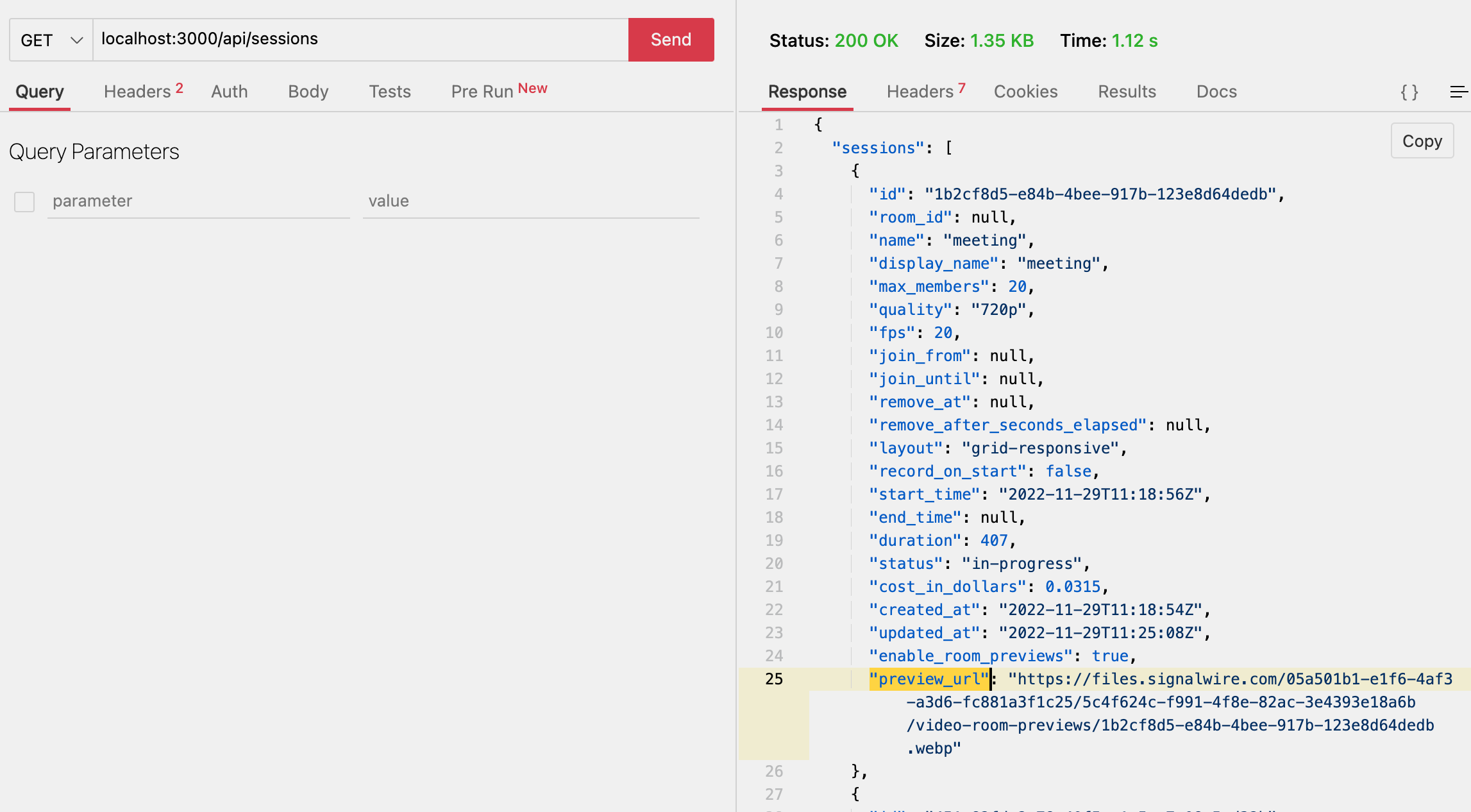

Finally, we want to display the previews of ongoing conferences in the home screen. The preview thumbnails of any
active SignalWire RoomSession can be downloaded from the preview_url
attribute of the session.
We can query for the list of active room sessions via the REST API at the room_sessions endpoint. Sending a GET request to this endpoint with a query parameter status
set to in-progress
will get us the list of active room sessions.
Again, since this is a REST API call, this will have to be done in the server and proxied to the client.
import axios from "axios";
import { AUTH } from "../../data/auth";
export default async function handler(req: any, res: any) {
try {
const sessionsResponse = await axios.get(
`https://${process.env.SPACE_NAME}.signalwire.com/api/video/room_sessions`,
{ auth: AUTH, params: { status: "in-progress" } }
const sessions = sessionsResponse.data?.data;
if (Array.isArray(sessions)) {
return res.send({ sessions, error: false });
} else {
console.log(sessions, sessionsResponse.data, sessionsResponse.status);
return res.status(400).send({ error: true });
} catch (e) {
console.log(e);
res.status(400).json({ error: true });
Sending GET request to '/api/sessions'
Now we have created an endpoint at /api/sessions
which, when called, sends a GET request to the room_sessions
endpoint
with the authentication information, and passes that information to the client.

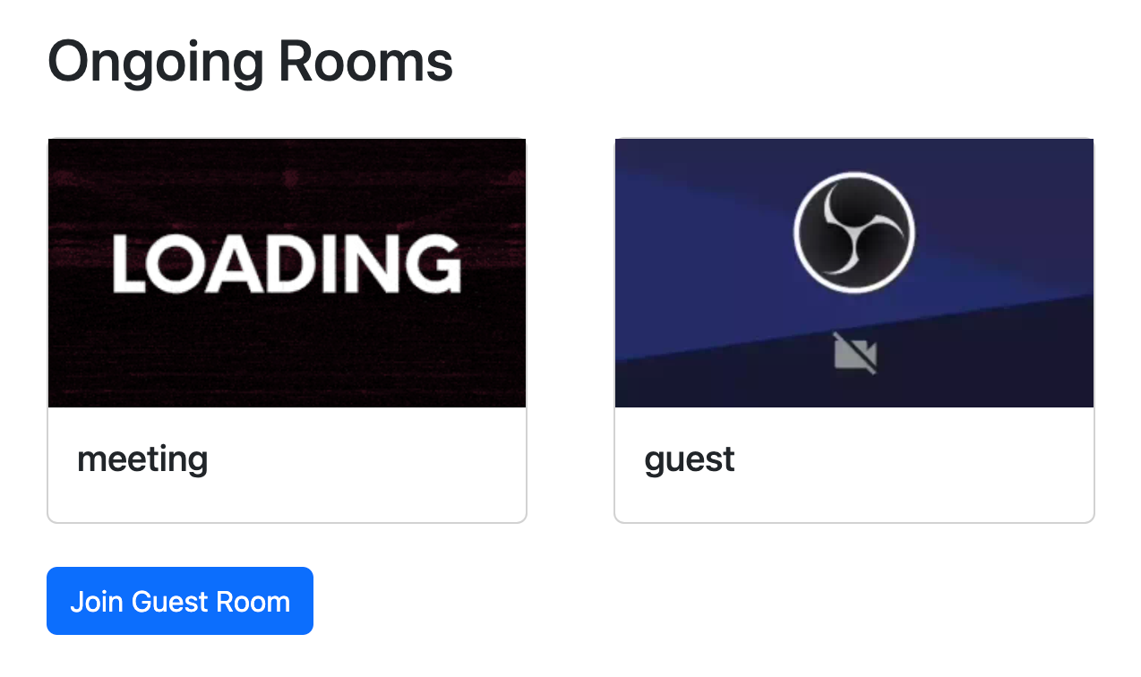

With that bit of backend in place, creating a frontend should be very simple. @signalwire-community/react
already comes
with a <RoomPreview/>
component (described in detail here).
import { RoomPreview } from "@signalwire-community/react";
import { useRouter } from "next/router";
import { Card } from "react-bootstrap";
import useSWR from "swr";
export default function RoomPreviews() {
const router = useRouter();
const { data: sessions, error } = useSWR("/api/sessions");
if (error || sessions?.error === true)
return <div>Error trying to access room sessions in progress</div>;
if (!sessions?.sessions || sessions?.sessions?.length === 0) {
return (
<div className="p-5 bg-light rounded-2 my-3">
<h4 className="text-muted">No ongoing rooms</h4>
</div>
return (
<div className={"d-flex flex-wrap justify-content-start gap-5 my-4"}>
{sessions?.sessions?.map((session: any) => (
<div key={session.id}>
<Card onClick={(e) => router.push(`/rooms/${session.name}`)}>
<RoomPreview
previewUrl={session.preview_url}
loadingUrl={"https://swrooms.com/swloading.gif"}
style={{ height: 150, aspectRatio: "16 / 9" }}
<Card.Body>
<Card.Title>{session.display_name ?? session.name}</Card.Title>
</Card.Body>
</Card>
</div>
</div>
Thumbnails of ongoing room sessions being displayed.
