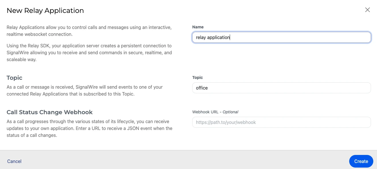

First, we need to create a new Relay Application resource. To do so, go to the "Resources" section from your sidebar, and create a new Relay ApplicationResource.
When configuring the Relay Application, set the context to "office" (to match what we have in the code).

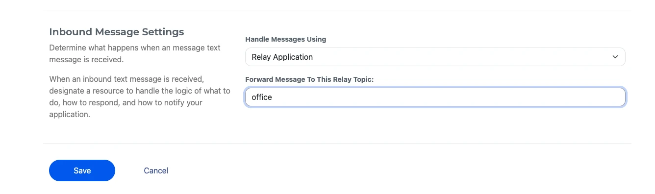

If you don't have a phone number yet, make sure to buy one. You will need at least one number to receive messages.
You can do that from the "Phone Numbers" section in the Sidebar. Go to the Settings page of the number you
want to configure. In the Inbound Message Settings
section, assign your relay application.
