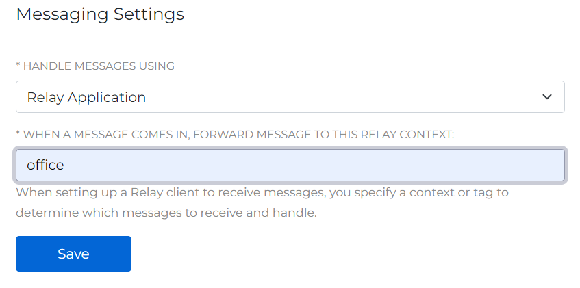

Log in to your SignalWire Space. From the Phone Numbers section, you can buy a new phone number. You will need at least one number to send and receive messages. After you have acquired a number, open its settings by clicking on "Edit Settings". Scroll down until you reach "Messaging Settings", as shown in the next figure, and configure it to:
- handle messages using a Relay application,
- forward the call to the "office" Relay context
Number configuration setting for handling Messages.
In Relay V3, a context is a named scope that allows you to group resources together. When you configure a phone number to handle messages with a Relay application and specify a context, all messages to that number will be delivered to Relay clients listening on that context.
