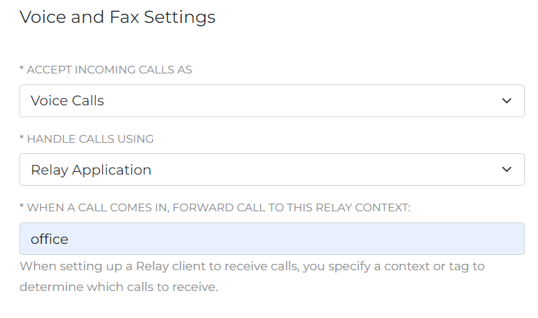

To handle calls using Node.js, you should first set up a phone number to handle incoming calls using a RELAY application.
Click the Phone Numbers tab on your lefthand side nav within your SignalWire Space, and click the specific number you would like to set up call forwarding on. If you don't have a number yet, now is the time to buy one!
To configure your number to handle incoming calls with a RELAY application, set 'Handle calls using' to 'RELAY Application', then specify the name of a topic (here we choose 'office').
