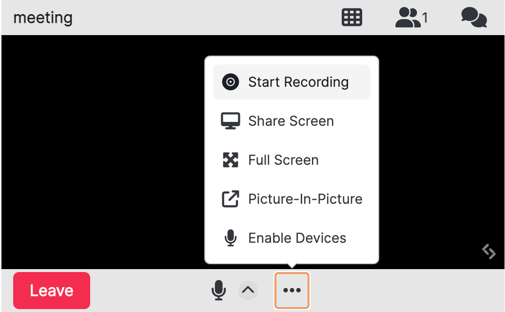

From the Embeddable Video Conference Widget
If you are using Embeddable Video Rooms in your website, just click the Start Recording option to start the recording.
Anyone with a moderator token will be able to start and stop recording. Embed the guest video room version on public pages for people that shouldn't be able to control recordings.
Starting a recording from the Embeddable Video Conference Widget.
