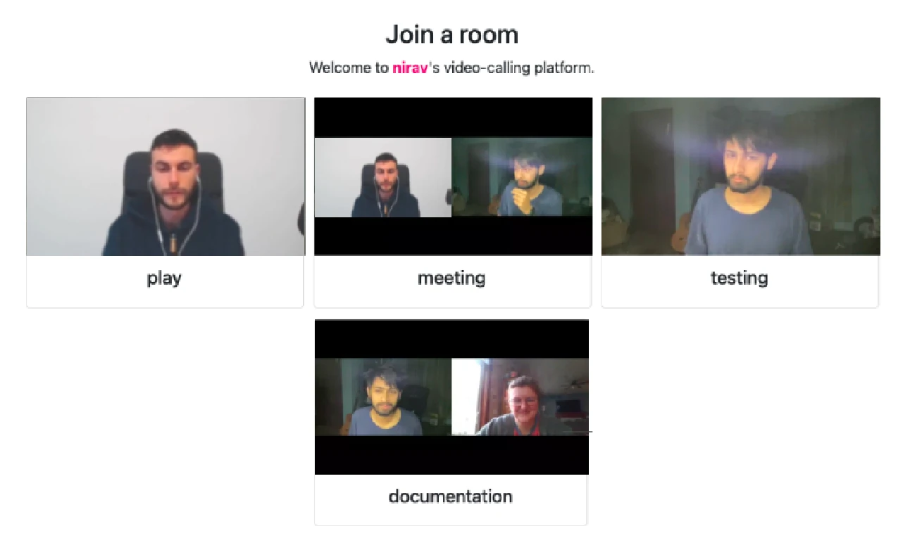

Introducing Video Previews
Video previews are live thumbnails of the ongoing room sessions. They refresh twice every minute, and record a small slice of the room. You can use these previews to represent a room.
