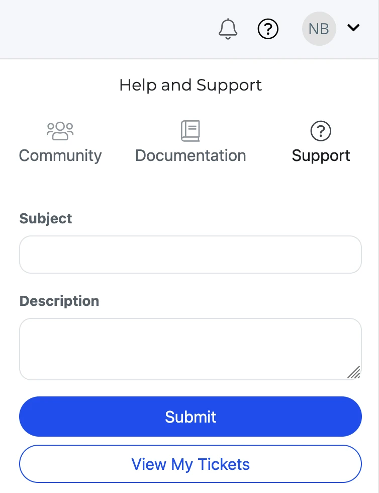

Creating a support ticket can be done through the SignalWire Dashboard by using the "Help and Support" link in the top right-hand corner and clicking on Support Portal.
A screenshot of the SignalWire Dashboard. A question mark icon labeled 'Help and Support' has been clicked, revealing options for Documentation, Slack Community, Submit a New Support Request, and My Support Requests. The latter two options are circled in red.
