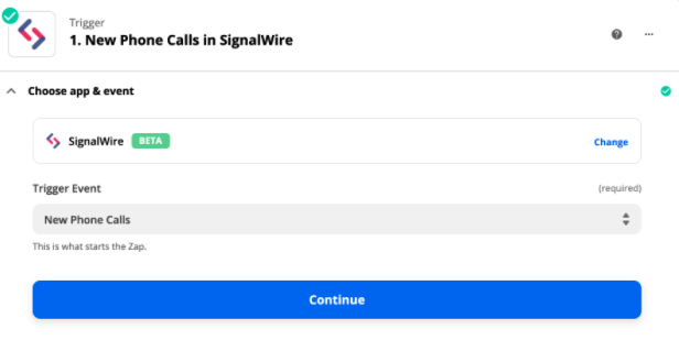

Click Make a Zap and let's get started! The first part of creating a Zap is that you have to identify the trigger. In this example, we will search for SignalWire and choose ‘New Phone Calls’ as the trigger event.
A screenshot of the new Zap pane in Zapier.

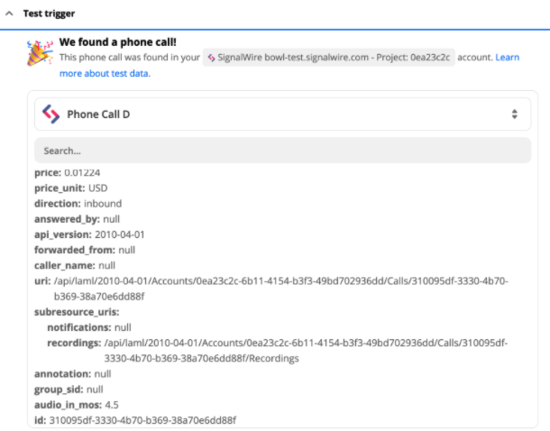

Next, you will click Test Trigger! This will use the authenticated account information and your specific trigger details in order to find an example of a call we can use throughout the process to test this Zap. If you have a phone number with a recording on your account, you should see it show up here with a full JSON response. If you have multiple examples, you will have the option to choose whichever one you prefer to use as your test.
A screenshot of the successfully tested trigger. A dialog reads, 'We found a phone call!' The text of the dialog includes the JSON response.

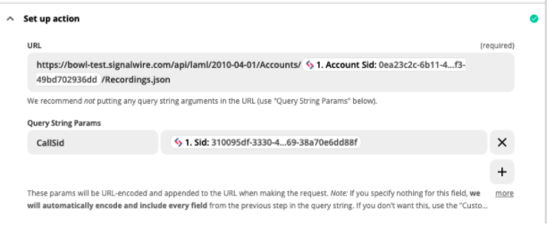

Next, click the + button in order to move on to the next step. You will need to search for Webhooks by Zapier and choose GET as the action event.
We need to identify the URL for the HTTP request as well as any parameters. For this example, we will be using the Call SID returned in the JSON response along with the Retrieve Recording API in order to get a recording link.
There is no SpaceURL parameter returned in the JSON object, so you'll need to hard code that to your own Space instead of the example below which shows bowl-test.signalwire.com. You can use the Account Sid parameter and the Call Sid parameter (denoted 'Sid') from the call object.
A screenshot of the Set Up Action pane.
Make sure to put your project ID and auth token in the basic auth spot at the bottom of this page. (ProjectID|AuthToken) You can put a | in between the two values to separate them.
This will return another JSON object in which you will see a parameter called 'sid' again except this time, it refers to the recording sid. CallSid in this object is denoted by call_sid, but we don't need it.
When you send the data to your next step, you just need to construct a URL using this recording SID.
The URL will look like this:
https://your-space.signalwire.com/api/laml/2010-04-01/Accounts/{{use_account_sid_parameter_from_Call}}/Recordings/{{use_recording_SID_parameter_from_GET_request}}.wav

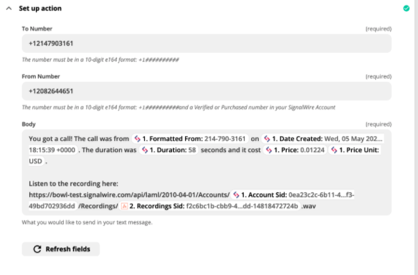

You will need to customize this part depending on the action that you want to take as part of your call flow. The next step could be sending this information in an email, pushing it to your database or CRM, or sending a message like this example shows. Either way, choose the + button in order to choose your next step, set up the event, and then you can use the URL above with any information you want to be sent along with it! Here is an example of what you might send in a message.
A screenshot of the Set Up Action pane. The Body of the action is text that shares the call details including from number, date and time, duration, and price. The text also links to the recording.
The message body that ends up being received looks like this:
You got a call! The call was from 214-790-3161 on Wed, 05 May 2021 18:15:39 +0000. The duration was 58 seconds and it cost 0.01224USD.
Listen to the recording here:
https://bowl-test.signalwire.com/api/laml/2010-04-01/Accounts/0ea23c2c-6b11-4154-b3f3-436dd/Recordings/f2c6bc1b-4a95-bd40-f45bf2a3373-6a25-412f-8add-14818472724b.wav
