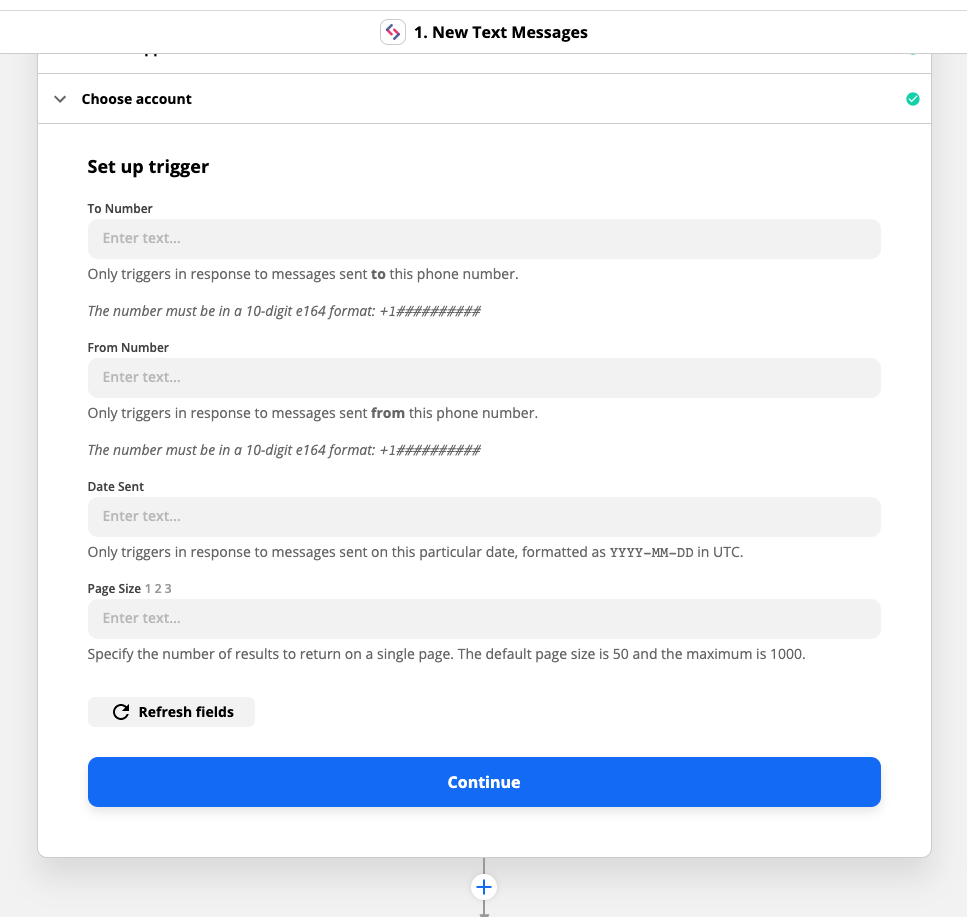

For the trigger, select SignalWire and choose whether you would like this process to begin with an incoming call or text. For this example, we'll be using the "New Text Messages" option. You'll then be prompted to Sign in to SignalWire. This is where you will use the API credentials we had discussed earlier. After logging in to SignalWire, you can then fill out the parameters in which the action is triggered. For this example, we'll just use the "To Number" parameter.
The "To Number" parameter in this scenario must refer to a phone number you own within your SignalWire Space and be written in E.164 format. For example, +12345678910.

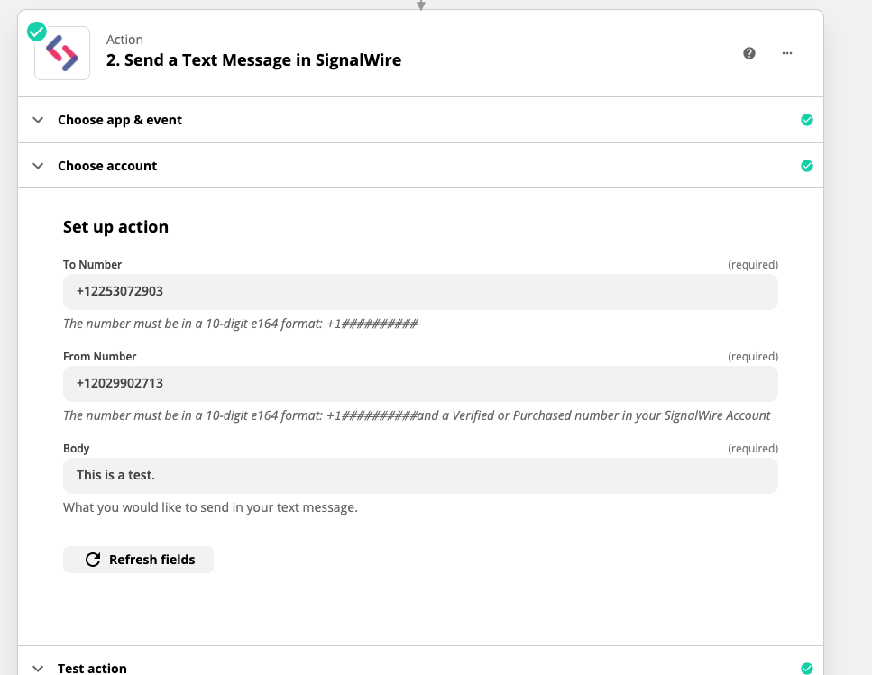

Once you've saved that information, Zapier will prompt you to test the trigger that you now have set up. Feel free to do so if you would like, or simply hit the "plus" button to continue without testing. The next thing we will do is configure the action by selecting SignalWire as the application in question. For the action event, you can select whatever action from the dropdown menu you would like Zapier to complete based on the trigger event we've already made. For this example, we will send a text message. You will then need to select your SignalWire account again. If you have completed the previous steps, your SignalWire API credentials will be saved in the dropdown menu here so you can select it without needing to reinput any information! You can then set up the action by inputting the phone number you would like to text to, the phone number within your SignalWire Space you would like to send the message from, and then the Body of the text message itself.
Once done, you can test the Zap! Once you see that the Zap was successful, you can turn on that Zap and let it ride!
