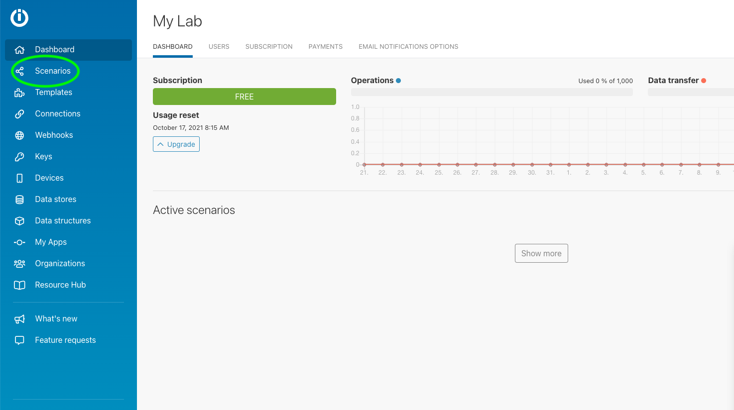

When you've logged into Integromat, click on the "Scenarios" tab on the left side of the window. Then click the "Create a new scenario button" located at the top right of the window. Feel free to refer to the pictures below!
The Integromat web application with the 'Scenarios' tab circled in green

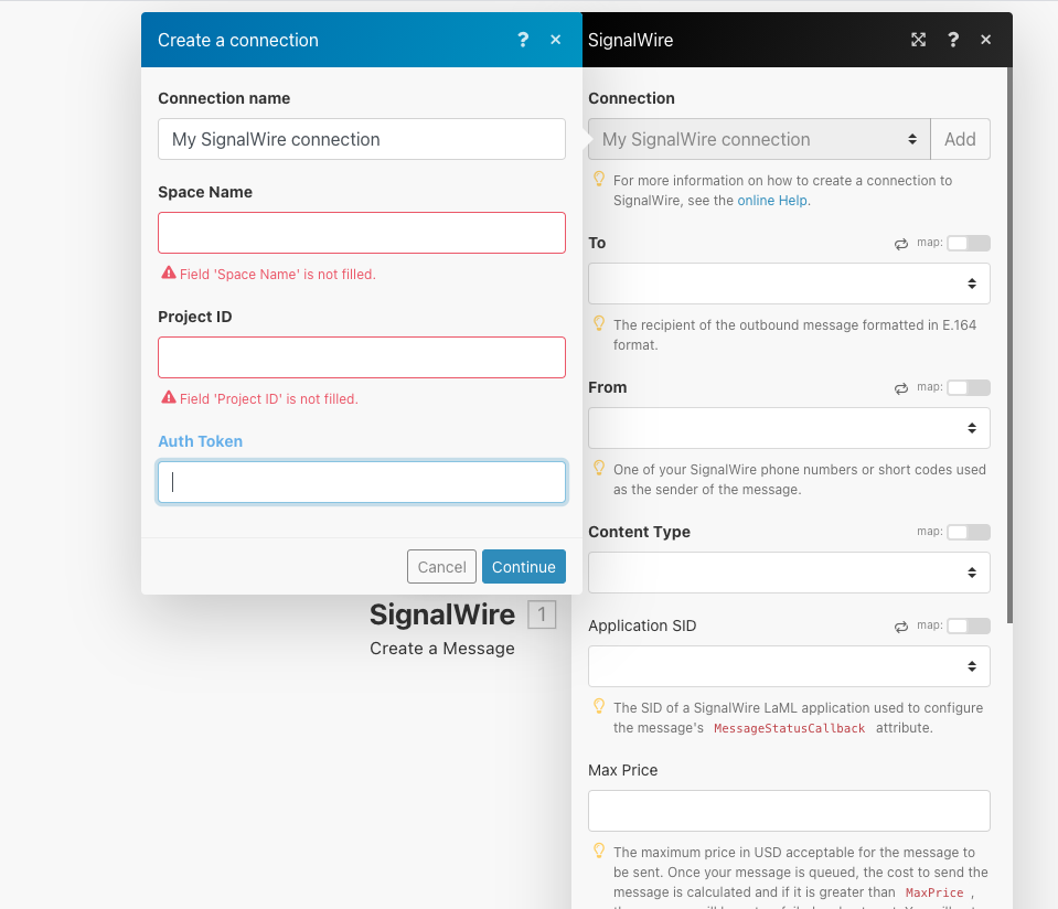

In the middle of your screen, you should now see a gigantic "Plus" button. Click that and search for "SignalWire". You can then select an action you want SignalWire to perform through Integromat. After selecting the action, you'll need to create a connection to SignalWire. Click on the "Add" button beside the "Connection" drop-down menu and add your API credentials that we talked about earlier (aka, your Space name, Project ID, and API Token) to the connection.
The 'Create a connection' dialog. The 'Add' button under the Connection heading has been clicked. The dialog includes text fields labeled Connection Name, Space Name, Project ID, and Auth Token
After you've clicked "Continue", input whatever information is required to complete the function at hand in the field to the right pictured above. For example, to complete a call or send a message, you will need a "To" and "From" number. To manually insert a "To" number, click on the "map" switch above the "To" field. Switch the "Content Type" to "Body" to manually insert a text or call body.
