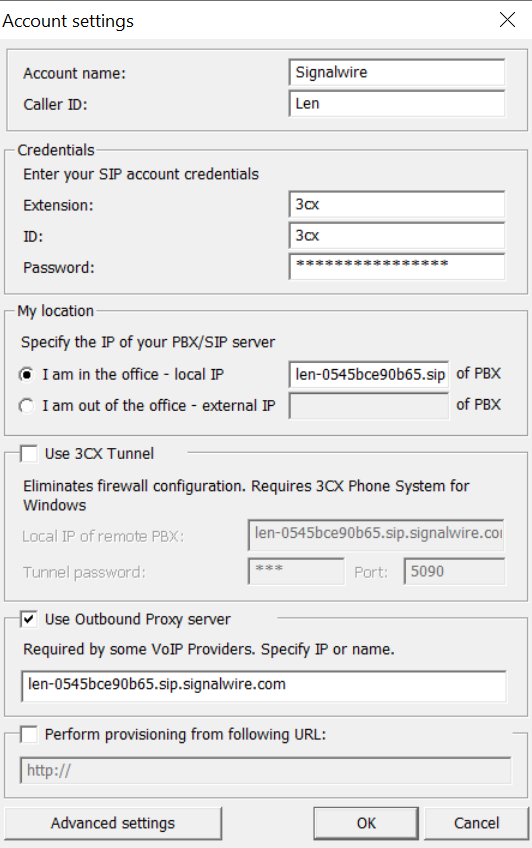

A screenshot of the Account settings page of the 3CX softphone app.
Account Settings Required Fields
  • Account name: This can be anything you want!
  • Caller ID: First name Last name is recommended, but entirely your call.
  • Extension: 3cx
  • ID: 3cx
  • Password: Signalwire SIP Endpoint Password
  • I am in the office - local IP: name-0545bce90b65.sip.signalwire.com
  • Use Outbound Proxy server: name-0545bce90b65.sip.signalwire.com
SIP Endpoint IP Address for I Am In The Office and Use Outbound Proxy Server
These two are generated when the sip endpoint credentials are created and it is unique to your Space. Follow the steps to create a SIP Endpoint in order to generate this domain!

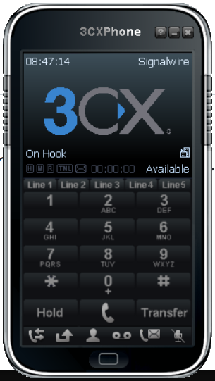

Once the sip endpoint is registered, "Available" will appear on the 3cx softphone.
A screenshot of the graphical 3CXPhone interface displaying the 'Available' dialog.
That's all there is to it - you are now set up with 3CX as your softphone and SignalWire as your VOIP provider!
