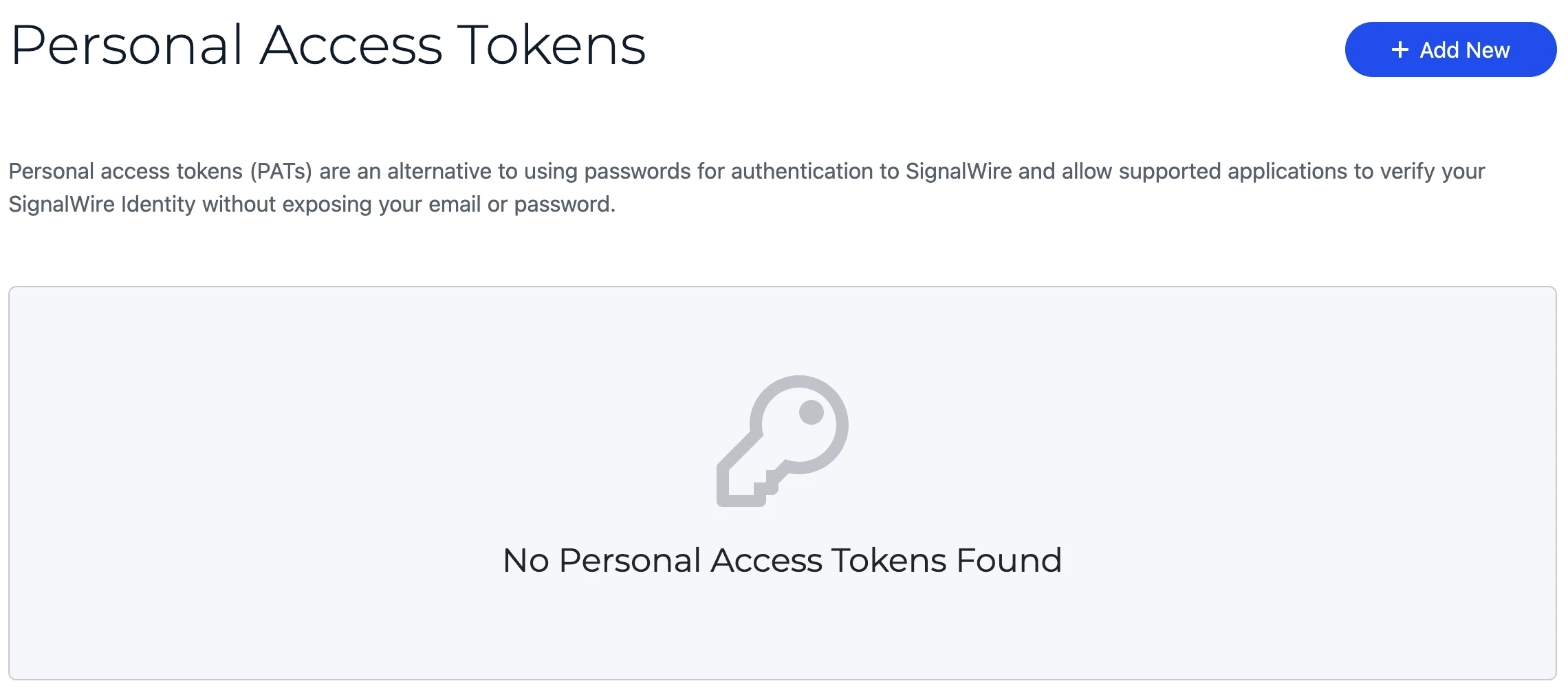

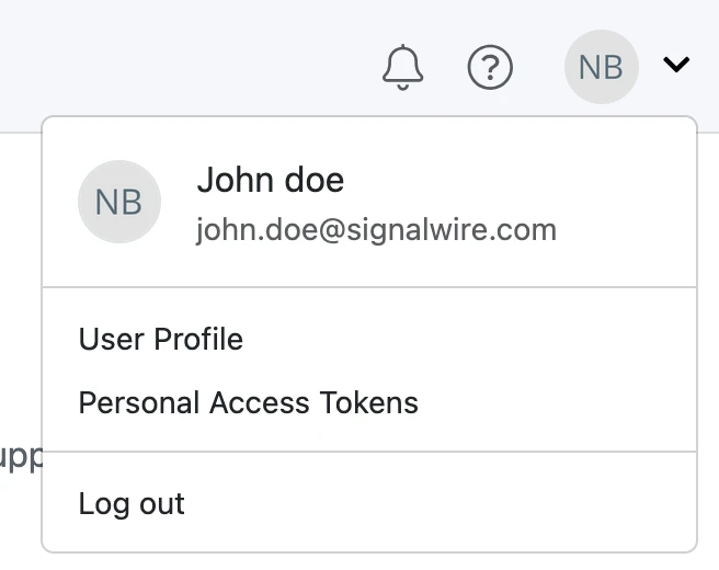

Getting an Access Token
A SignalWire account is now required to download the pre-build FreeSWITCH binaries. First create a SignalWire Space, then go to the Personal Access Tokens section located on the left side of the Dashboard. From there, create a Personal Access Token. Click here to learn more.
Personal Access Tokens Page
A Personal Access Token with the time it was created, when it was last used, and the ability to revoke it.
A Personal Access Token.
