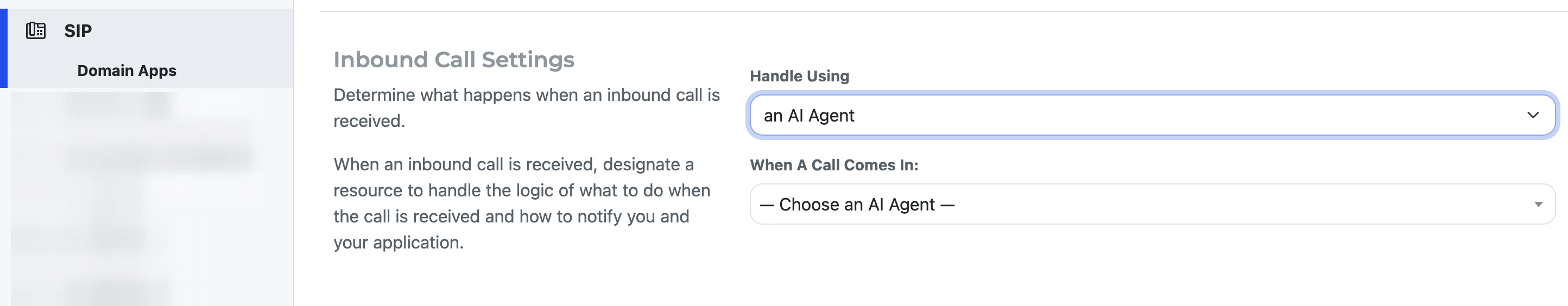

Once you have created your domain application, you can now configure it to handle calls with your AI agent. In the Domain Apps page, click on the Edit button or the name for the domain application you want to configure.
In the Edit Domain App page, you can configure the domain application to handle incoming calls with your AI agent resource. Click on the Handle Using select box and choose an AI Agent. Then under the When a Call Comes In section, select the AI agent you want to use for the domain application.
