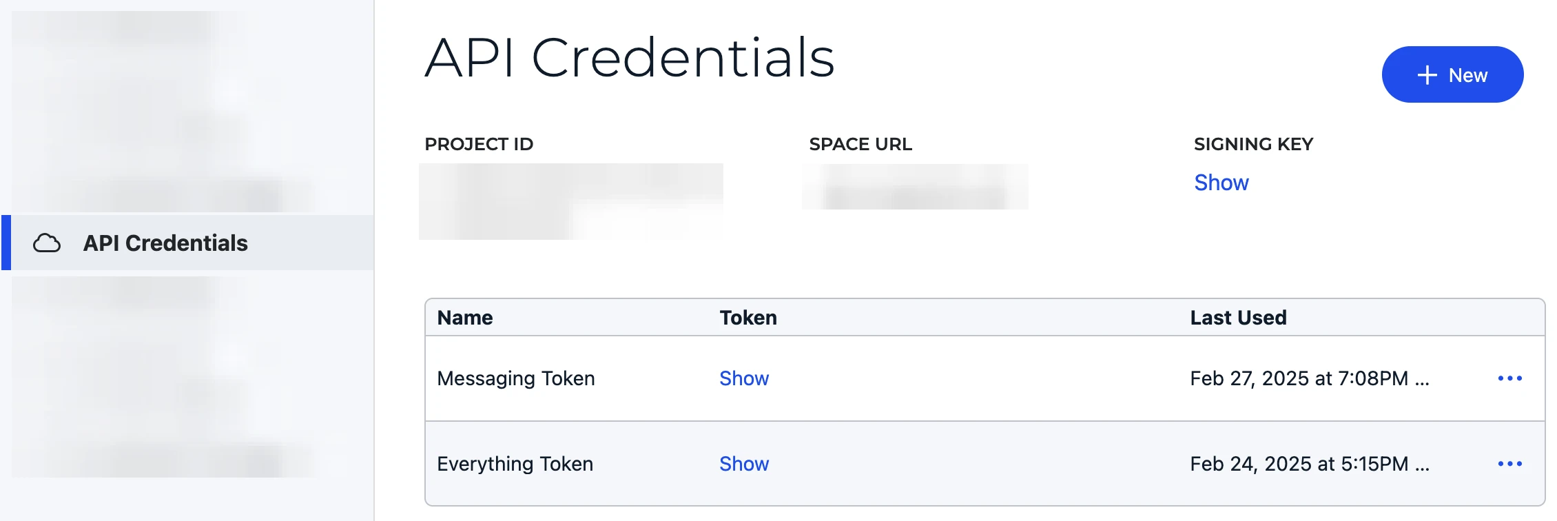

You can find your personalized signing key in the API Credentials Space of your Dashboard. Click "Show" to display the key and a copy icon to easily copy the signature into your code. Each project in your Dashboard will have its own signing key for verification. You can reset the signing key by clicking the reset button. Please note that it takes about a minute for the new key to be active. You will also be able to see the new key before finalizing the reset request so that you can copy it to wherever it needs to be updated.
A screenshot of a SignalWire Space showing an active Project called 'Main'. The API tab is selected. The API Credentials section lists information about API Tokens including Project ID, Space URL, and Signing Key. Signing Key is circled in red.
API Credentials page
