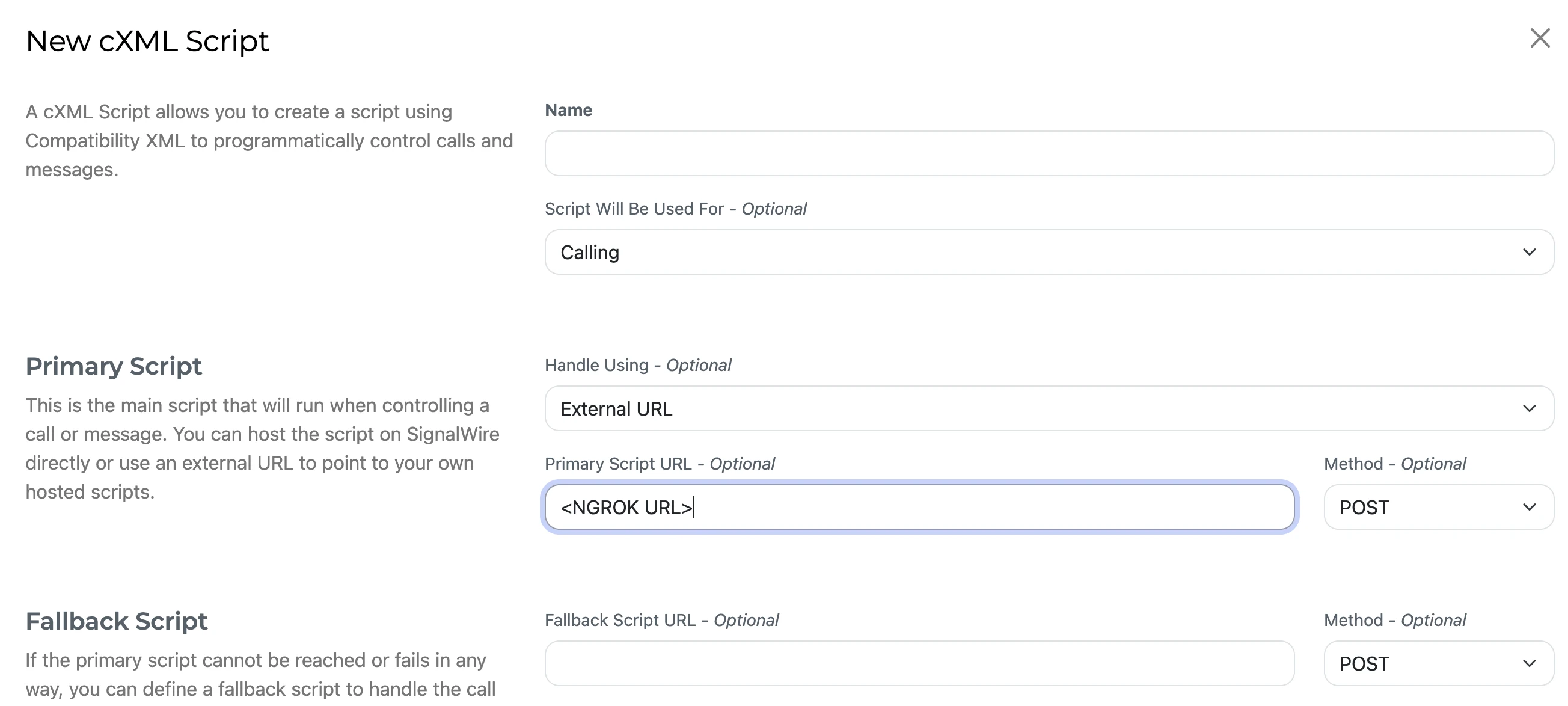

Next, create two new Resources from the Resources section from the sidebar. For both, select a Script and choose type as cXML. Set the primary script to "External URL". For one, point to your-ngrok-domain/voice. For the other, point to your-ngrok-domain/sms. Name these resources accordingly to recognise them better later.

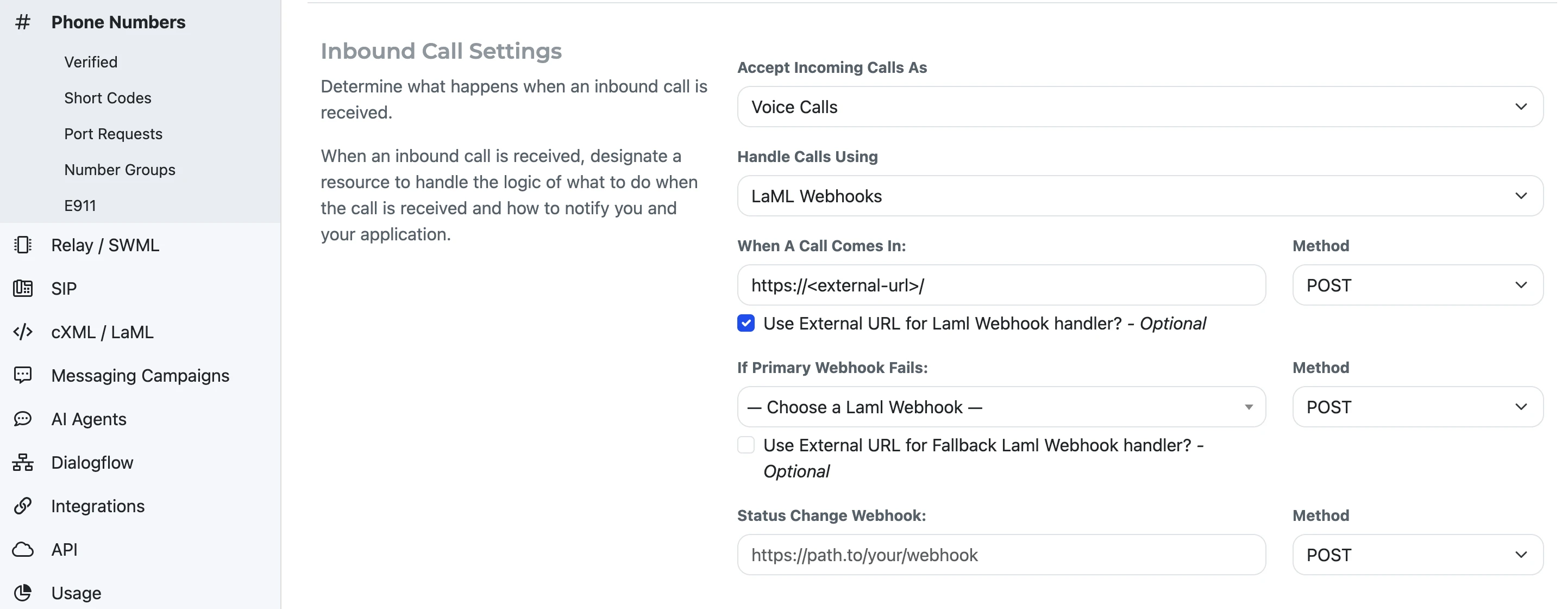

Then, open the phone number settings. In the Inbound Calls Settings section, select the resource you created for voice. Similarly, in the Inbound Messaging Settings section, select the resource you created for SMS.

Configure your number to "Handle Calls Using" using LaML webhooks and point it to your-ngrok-domain/voice.
Configure your number to "Handle Messages Using" using a webhook and point it to your-ngrok-domain/sms.
