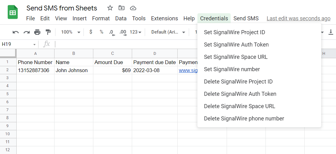

Create custom menus
The custom menus we’re creating will appear on Google Sheet’s menu bar along with File, Edit, View, etc.
A screenshot of the Google Sheets UI in the same spreadsheet. The menu bar (starting with File, Edit, View and ending with Help) is outlined in red.
This is where the custom menus will appear.
The name of our custom menus will be Credentials and Send SMS. The Credentials menu will include a dropdown menu where you can enter/remove your SignalWire Project ID, Auth token and Space URL. The Send SMS menu will allow you to send SMS to all numbers on your sheet, or to send to only specific numbers that fall between a given date range.

After you’ve saved your code, you’ll need to reload your Google Sheet. Close and re-open the page or click refresh and you should now see your new menu options at the top of the page. It may take a few seconds for those menu options to appear each time the Google Sheet is opened so if you don’t see them immediately, just wait a few seconds.
A screenshot of the Google Sheets UI. In the menu bar after Help, the new menu bar items Credentials and Send SMS have been added. 'Credentials' has been selected, allowing the user to set or delete the SignalWire Project ID, Auth Token, Space URL, and phone number.
Our custom menu options.
Go through your credentials’ steps and enter your Project ID, Auth Token, Space URL and the SignalWire number you’d like to send the SMS from. To find these credentials, log into your SignalWire Space and select API from your Dashboard. If you haven’t done so already, you’ll need to create an API token and for this example you’ll need to make sure that ‘Messaging’ is enabled for the token.
