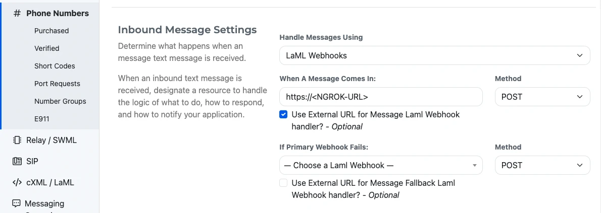

Configuring the number
Now that the code is ready and the HTTP endpoint is reachable from the web, we need to configure our SignalWire number to access it.
First, we need to create a new cXML script resource that points to your ngrok URL. To do so, go to the "Resources" section from your sidebar, and create a new Script Resource. Select the Script type as cXML.
When configuring the cXML script, select the "External URL" option, and paste the ngrok URL.
If you don't have a phone number yet, make sure to buy one. You will need at least one number to receive messages.
You can do that from the "Phone Numbers" section in the Sidebar. Go to the Settings page of the number you
want to configure. In the Handling Inbound Messages
section, assign your cXML script.
Try sending a message to the configured phone number: after a few seconds you'll receive an automated reply, whose content will be different depending on what you wrote.
