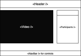

The SignalWire Video SDK provides the video-feed of all participants in the video-call out of the box as a single stream. The video-feed is composited at SignalWire servers to ensure optimum use of bandwidth and scalability, which means that it isn't necessary to write complex code for layouting and composing the video stream. The SDK also provides an API to perform actions on the video feed, like muting videos and changing layout of the stream.
So we need to write our React code as a wrapper to the SDK's video stream. React will provide the user interface surrounding the stream to ensure members can join, leave, and otherwise interact with the video call.
