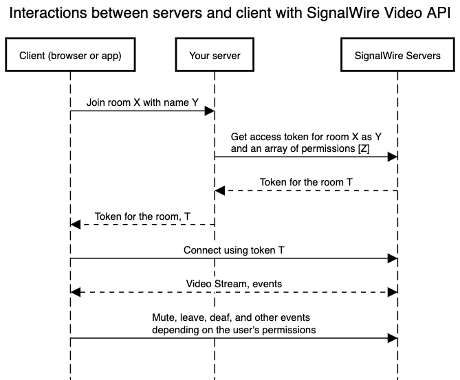

Even though SignalWire provides the platform for all video communications when you’re using the Video APIs, you still need to write some server-side logic to proxy the SignalWire REST APIs. Your server-side script should work to authenticate your users, manage their permissions, and relay the tokens from the SignalWire's Video REST APIs to the client's browser. The token has information like the room name, and the permissions for the token’s user. The JavaScript SDK running in the client's browser will then use the tokens to establish direct connection with the SignalWire servers.
Your server doesn't have to do much, as you'll see in code below:

The source above is all it takes to write a functional backend for SignalWire Video SDKs. At the most basic level, all it has to do is provide a single endpoint (here named /get_token) which takes the name of a room and the name of the person, and returns an JWT token. The client-side SDK will handle the rest.
