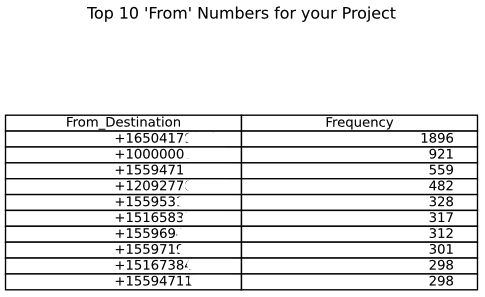

## Display your most popular incoming numbers through a data table
# Isolate the 'from' number column of our data frame and count the frequency of each unique occurance
df_from = (df['From'].value_counts()).reset_index()
# Take only the 10 most popular from destinations and add labels to our data frame
df_from = df_from[:10]
df_from.columns = ['From_Destination', 'Frequency']
# Turn data set of Most Common From Numbers into a subplot table
fig, ax =plt.subplots()
ax.axis('tight')
ax.axis('off')
the_table = ax.table(cellText=df_from.values,colLabels=df_from.columns,loc='center', )
ax.set_title("Top 10 'From' Numbers for your Project")
ax.axis("off")
# Save figure as a new page in our pdf document
export_pdf.savefig(fig, bbox_inches='tight')

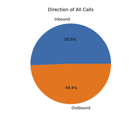

## Create Pie Chart displaying the percentage of inbound and outbound calls
# Count the number of occurances of inbound and outbound within the 'direction' column
df_direction = (df['Direction'].value_counts())
#Use matplotlib to turn our data frame df_direction into a histogram
fig=plt.figure()
direction_calls_labels = ['Inbound', 'Outbound']
pie_chart=plt.pie(df_direction, autopct='%1.1f%%', labels= direction_calls_labels)
plt.title('Direction of All Calls')
export_pdf.savefig()

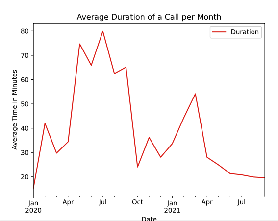

## Create a Lineplot displaying the average duration of Calls per Month
# Create a data frame that groups calls by Month and find the average of each month
grouped = df.groupby(df['Date'].dt.to_period('M')).mean()
# Use the grouped data frame to create a lineplot of mean duration per month
fig=plt.figure()
lines=grouped.plot.line(title='Average Duration of a Call per Month', color= 'red')
lines.set_ylabel("Average Time in Minutes")

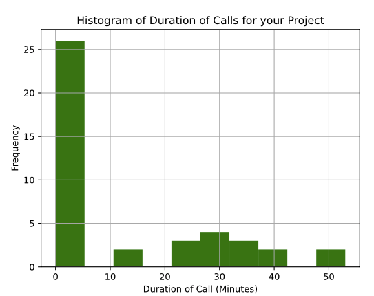

## Create a histogram to demonstration duration of calls
# Extract on the duration column of our data frame and create histogram
fig=plt.figure()
hist=df.hist(column='Duration', color = "green")
plt.title('Histogram of Duration of Calls for your Project')
plt.xlabel("Duration of Call (Minutes)")
plt.ylabel("Frequency")
