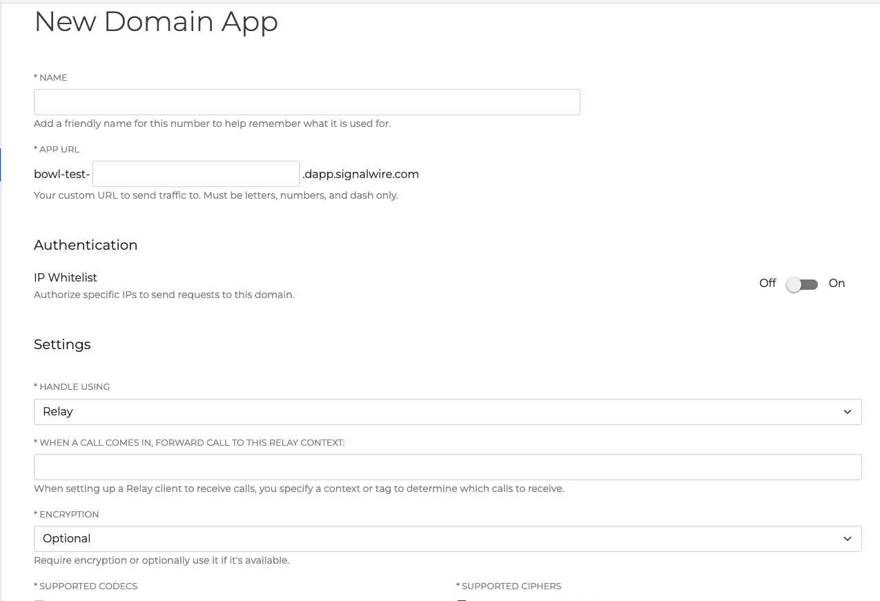

If you would like to do inbound BYOC (i.e. send your carrier traffic to SignalWire), you will need to create a domain application. Domain Apps allow you to send SIP traffic to a custom domain and use SignalWire APIs to manage the incoming request. You can do this under SIP -> Domain Apps -> Create a Domain App, or via the Domain Apps API.
You can select to handle using Relay or using LaML Webhooks (AKA Compatibility API/XML). You can also dial another SIP endpoint in both Relay and Compatibility XML!
Whitelisting IPs
It's VERY important to whitelist the IPs that you want to allow through - if you do not select this option, anyone who has the URL could send traffic to your custom domain app.
Once you are done creating the domain app, you can test by directing the traffic from your SIP endpoints to the custom domain.
