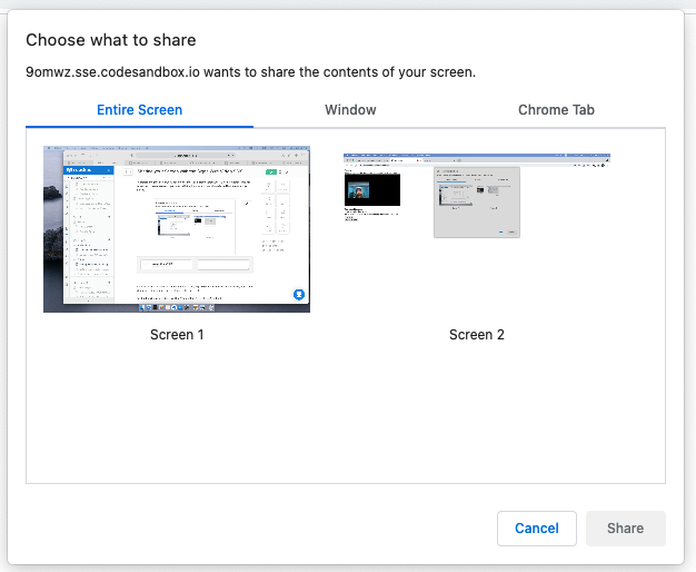

To start sharing the screen, you need to call the RoomSession.startScreenShare() method. This will make the browser prompt your user with the browser's screen share dialog like the one shown below.
After the user selects which screen or tab to share, SignalWire Video SDK will automatically add a new video feed with your screen's contents to the video call.
RoomSession.startScreenShare() asynchronously returns a RoomSessionScreenShare object.
