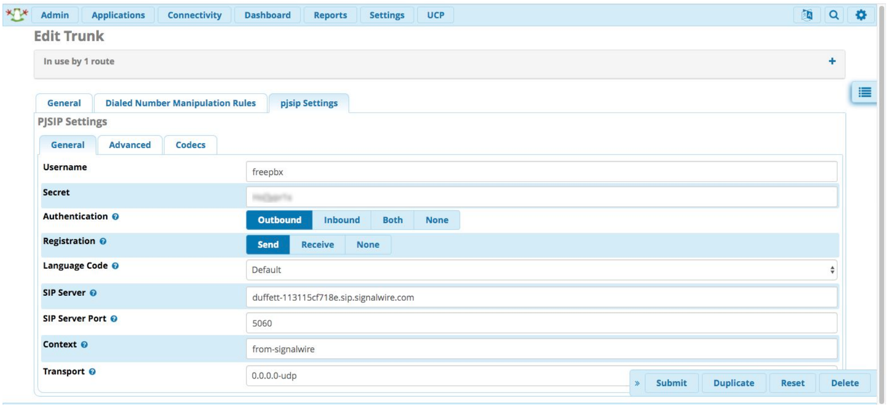

Then, on the PJSIP Settings tab and the General sub-tab, enter the following:
Username: freepbx (the name you gave the SIP endpoint)
Secret: (the password you gave the SIP endpoint)
SIP Server: YOURSPACE-123456abc.sip.signalwire.com (your space URI)
SIP Server Port: 5060 (standard SIP port)
Context: from-signalwire (default is ‘from-pstn’, but you must change it)

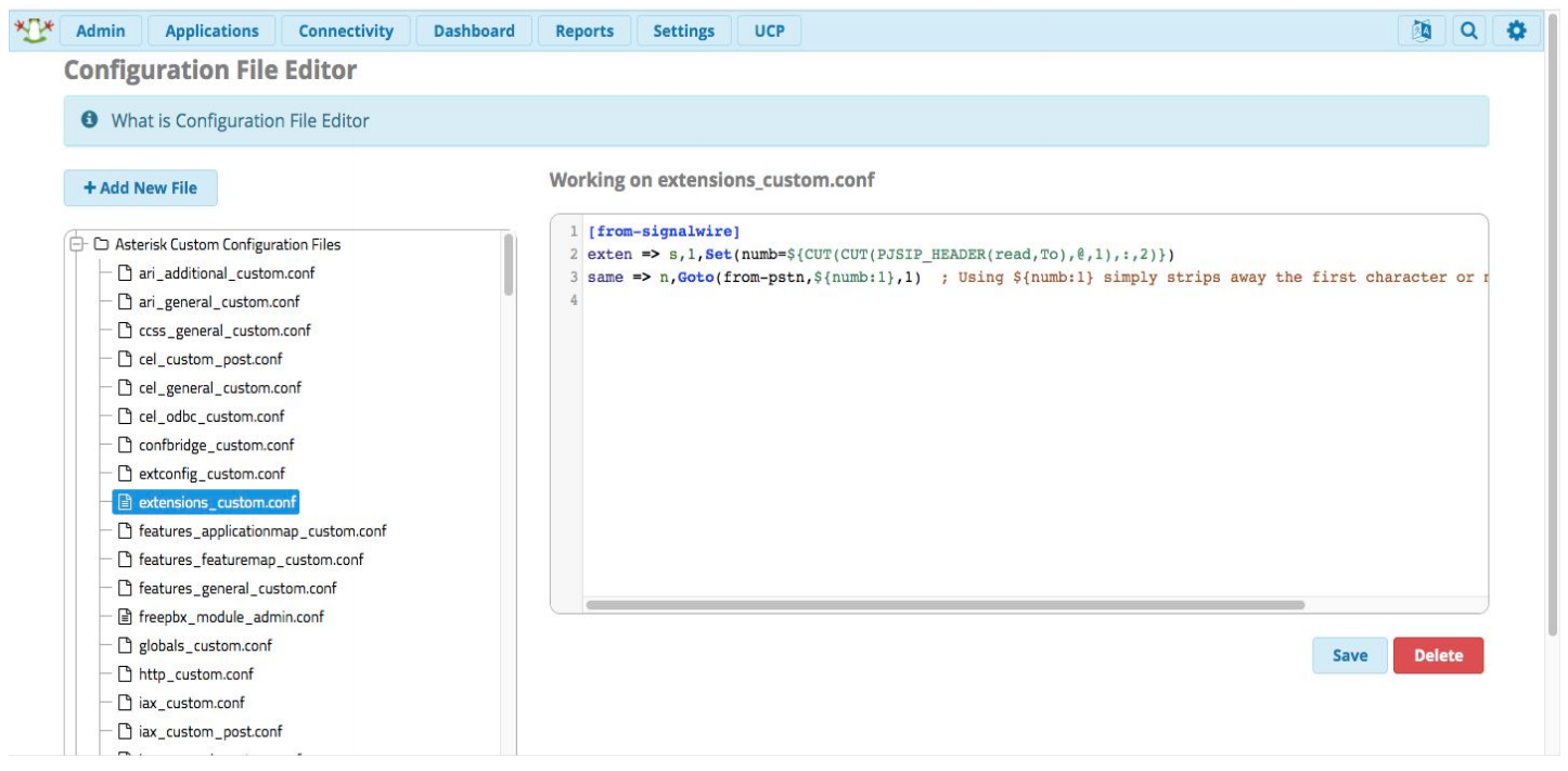

There is a small amount of dialplan script to add (which we will place in a context called "from-signalwire" - remember, we set this in the above steps), in order to extract the dialed number from the SIP Header, before passing the call to FreePBX for normal processing.
We do this by entering the following lines in a file called extensions_custom.conf (which may be empty) using the inbuilt config editor in the Admin menu:
[from-signalwire]
exten => s,1,Set(numb=${CUT(CUT(PJSIP_HEADER(read,To),@,1),:,2)})
same => n,Goto(from-pstn,${numb:1},1)
The editor is at Admin > Config Edit > extensions_custom.conf:
