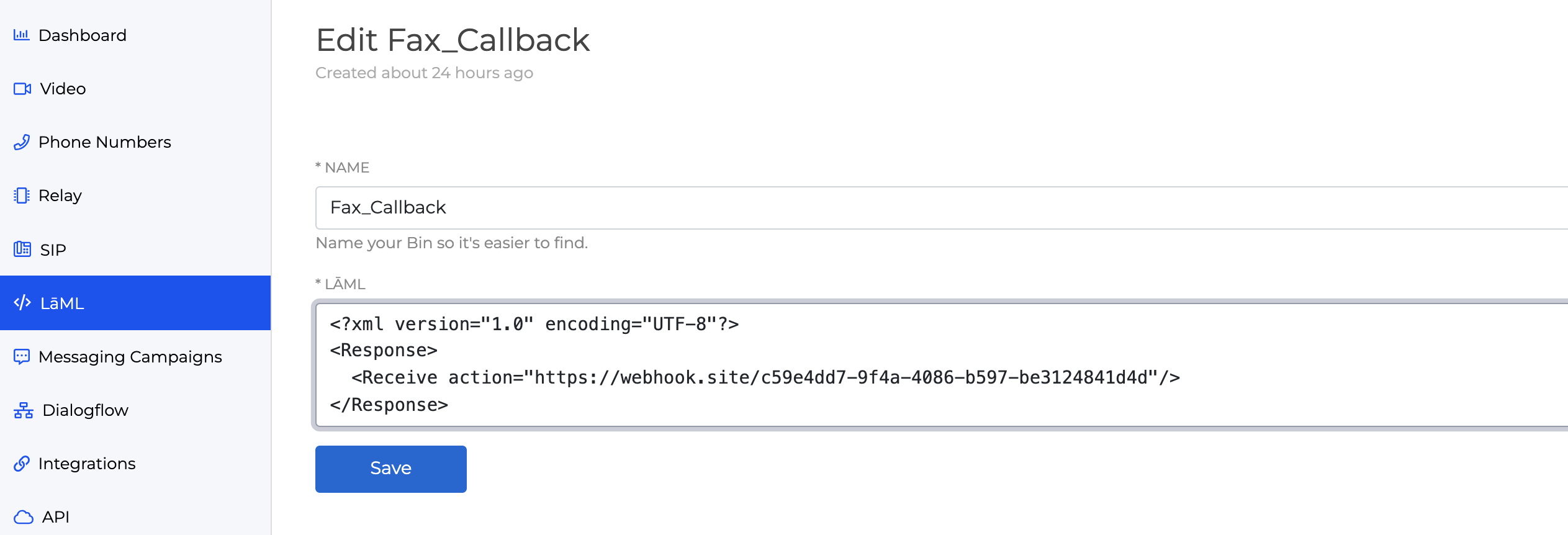

In order to achieve this via XML, you will have to navigate to the LaML section on the left side of your SignalWire Dashboard and select + New to create a new LaML Bin.
We then need to enter in the XML language for receiving a fax into our LaML Bin. The below code is taken from the Receive a Fax in Compatible XML example .
<Response>
  <Receive action="https://YOUR_URL_EXPECTING_A_CALLBACK."/>
</Response>
Enter in the above XML and your page should now look something like this below.

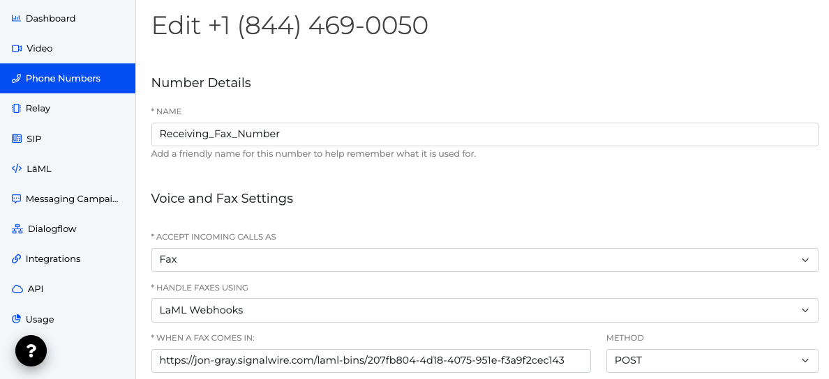

Lastly, we must associate a phone number to the webhook created via a LaML bin. To do this, we must navigate to Phone Numbers on the left side of your SIgnalWire Dashboard. Click on a number and select Edit Settings
Note that we set 'Accept Incoming Calls As:' Fax, We 'Handle Faxes Using:' LaML Webhooks, and then paste in our LaML Bin URL.

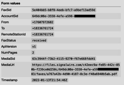

Once your fax has been received, you should receive a payload to your actionURL that looks similar to the one below. Feel free to read up more on Request Parameters and Additional Callback Parameters for more information on the data being sent.
