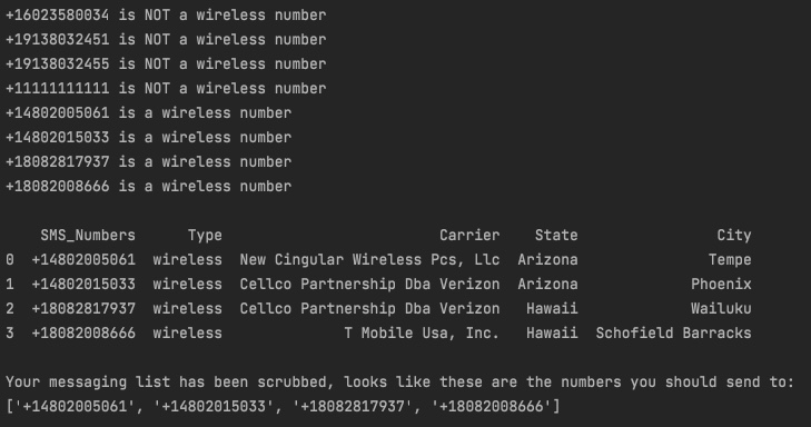

Here we do a lookup for each number in numbers_to_check and if it is a wireless number we get more information, but if it is a landline we just print to the console confirming it is not a wireless number.
for i in numbers_to_check:

    # If the number is sms enabled, we will append our dataframe with it's e164 format, the location and the type of number
    if line_type == 'wireless':
        # Let the console know which numbers will be added to our dataframe
        print(i + ' is a wireless number')

Prepare dataframe, print it, and export to CSV
# Turn each of our columns into a complete data frame
final_dataframe= pd.DataFrame(({'SMS_Numbers': sms_enabled_number_list, 'Number Type': line_type_list, 'Carrier': line_carrier_list, 'State': line_location_list, 'City': line_city_list}))
# Display all rows and columns of the final_dataframe
pd.set_option('display.max_rows', None)
pd.set_option('display.width', None)
pd.set_option('display.max_columns',None)
# Lets print out our dataframe and see what this all looks like!
print()
print(final_dataframe,"\n")
print( 'Your messaging list has been scrubbed, looks like these are the numbers you should send to:')
print(sms_enabled_number_list)

The Output
