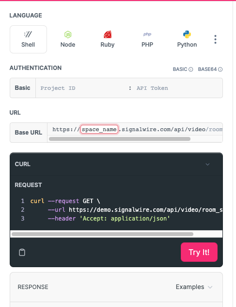

We will use Python to accomplish this, but check out our handy Try It feature in our docs by replacing the variables here with your own and running it in the browser. You can then easily copy the generated code in cURL or your favorite language!

The API requires that you authenticate yourself using your Project ID, API Token, and Space URL. If you do not know where to find these values, check out our guide here!

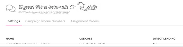

You will need a campaign SID of the campaign containing the numbers you want to remove. Your campaign SIDs can be found in your portal under Messaging Campaigns -> Campaigns or by listing campaigns using our endpoint.
